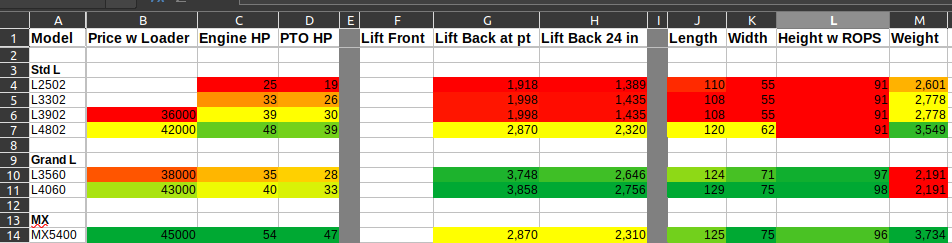

Updated my compare tracker with the Grand Ls and MX5400. The MX has been a consideration but not sure I could make that work financially. The Grand L wins outright on 3pt hitch weight capacity, but the Kubota spec sheet says it's lighter than the 3 smaller Standard L models? Seems odd. Is the advantage of the Grand L 3 point hitch the ability to more easily add remotes for something like a flail mower, compared to the Standard L?
The L4802 would be pushing the budget, especially after adding tax, KTAC, and implements. However it seems like a completely different class of tractor compared to the L3902 and has several advantages that I'm looking for like the larger frame size and weight.

Implement purchase can be deferred and added over time. Upgrading the base machine not so much. I think you have a very clear picture of your options and the trade offs.
PS> A major feature of the Grand L HST is computerized management of the power train. It monitors changing loads and power output and automagically adjusts them on the fly without operator intervention.

I don’t think there is much cost difference between a L4802 and a MX5400, but a significant difference in capabilities.
About $3k difference with a basic configuration of loader and bucket. What would be some of the selling points I should look into with the MX5400 vs L4802? MX5400 is definitely wider and longer, and weighs a little more than the L4802 but seems to lift about the same weight on the 3pt?
