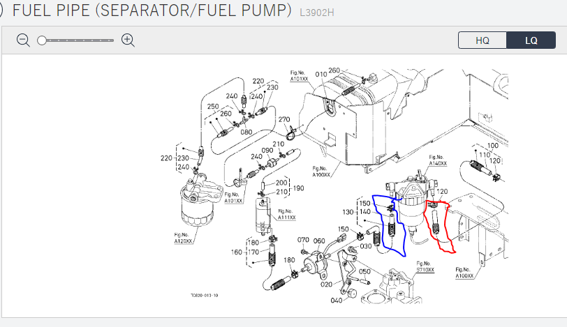

The Fuel system is a loop what the system doesn't use for the motor is returned to the tank.
Note: DO NOT open or disconnect any of the high pressure fuel lines, Either hard or soft lines.
Remove the line that feeds the separator (red) you should get good flow.
If you don't get good flow you have something in the tank restricting flow.
If you get good flow, Re connect, remove the output line (blue) you should get good flow.
If you don't get good flow, pull the input fitting and check for obstruction.
If you get good flow move on to next picture.

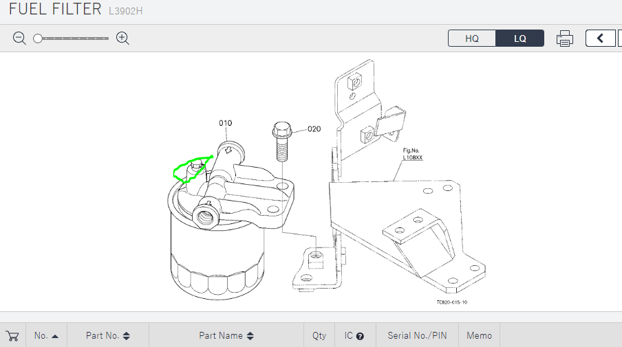

Pull the bleeder (green) and turn the key to run, do not crank or start it.
You should get good flow.
If you don't get flow, the electric lift pump electrical feed or the pump itself has failed.
If you get good flow, replace bleeder and leave it cracked and leave the key in the on position for several min to bleed the system.

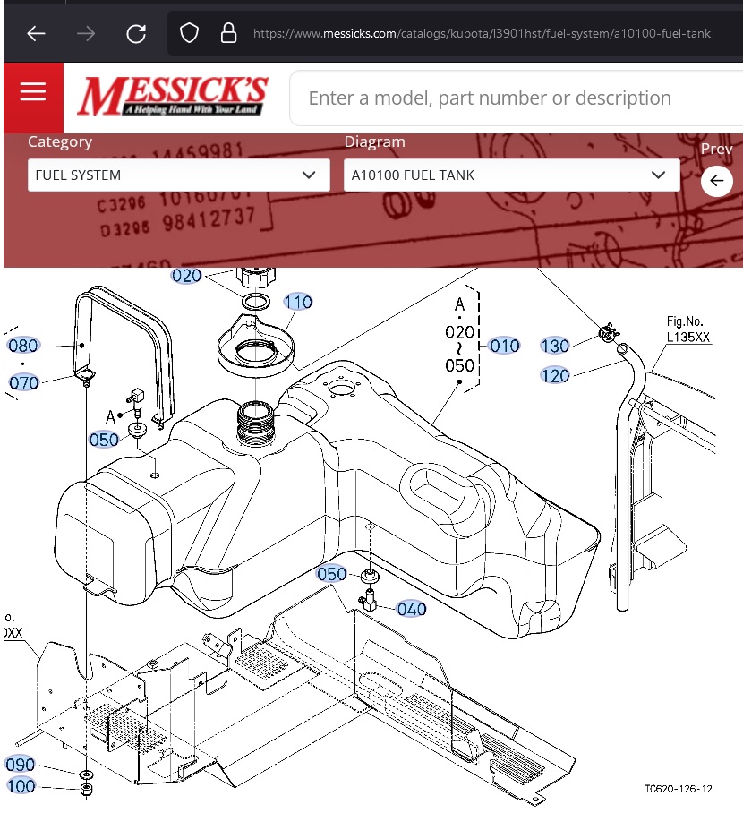

It's a Kabota L3902. It's definitely trash in tank. About every 1-2 fill up or 10-15 hours it gets blocked. I pull off line from fuel grommet at bottom of the tank and physically, by mouth, blow into the tank by attaching a short tube to fuel grommet. It clears and immediately starts flowing. I completely drained deisel fuel tank twice and have run clear deisel thru to try to wash out. Can I remove the grommet and would I then be able to see the screen at bottom of tank or is it part of the grommet. I am trying to avoid removing the tank.

Tank has grommet exiting tank. That's clogged. Fuel filter is clean and is after grommet, so clog is not there. Clog is in tank before grommet or possibly inside grommet. Diagram doesn't show where the screen is. I was told there is a screen somewhere between grommet and tank. Is it partner the grommet? And if I pop the grommet out isn't that just then a hole leading to the bottom of the tank. Why not just pop out and thoroughly flush wirh deisel instead of pulling the tank to do the same. My main question is could there be something inside the grommet that keeps falling back into it to block it.

...I was told there is a screen somewhere between grommet and tank....
Who told you this? It's just that I've never heard of a screen in the tank... there are several threads about junk in fuel tanks that blocks the outlet. Don't know of one that was fixed without removing the tank (which is a major PITA job).
There was one guy recently that wanted to try and run a shop-vac into the tank to clear the junk out... (after emptying out the fuel) but like a fair amount of posters, he never came back to report success or failure.
As you can see, the tank is an odd shape and would most likely need to be flushed a few times to make sure to get all the junk out. Mental Note to self - - Don't let junk get into the tank!!!!
Algae on the other hand, can grow in the tank and clog the outlet... {Insert icon of beating a dead horse}
I had a similar problem with my ZD1211 with resolved after removing the grommet and allowing the debris to flow out. I also used a clothes dryer hose brush (typically for removing lint in the vent hose) which was large enough to agitate the debris and get it to flow out. The brush kits are available to HD and Lowes and attach to a 3/8 drill to spin it. Reinserting the grommet was tedious but doable. I could not find a replacement grommet part number on any Kubota diagrams.
