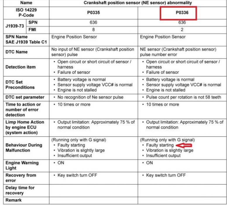

Yesterday while inspecting it and trying to start it I noticed that there is a PO336 code coming on. I researched that a bit and it seems that code may come on if the tractor shuts down abruptly. I'm not sure, though.

I believe that it has to do with the RPM dropping below a set threshold with the key still ON.
The code is stored in the ECU, and can be reset by a dealer.
You might also check to see if your machine has the computer program upgrade to minimize this issue.
While you can check the PTO switch, seat switch, HST switch; on your model they go through the ECU. I would not mess with the seat switch unless electrically disconnecting it to ohm the actual switch itself.
Since the code is showing, I would tackle that first as it will prevent the machine from starting.

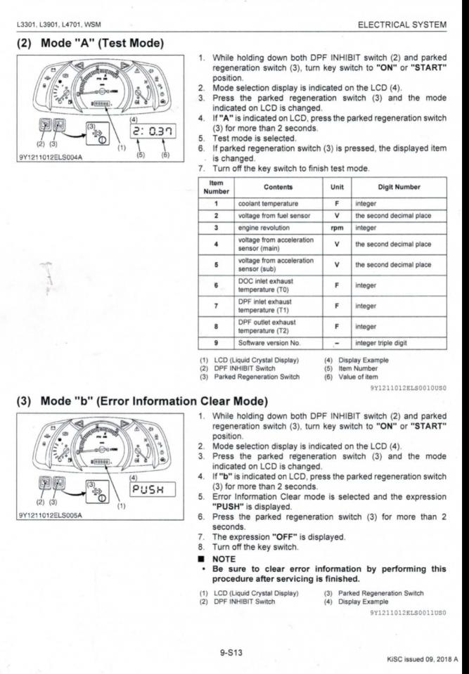

I spoke with my dealer today. He emailed me the process to clear fault codes.

I reset the codes and still can't get it started. I guess I'll keep looking into the switches.

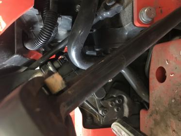

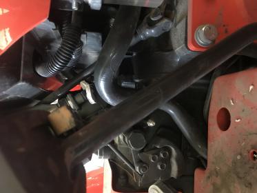

I got it started. It was the HST pedal switch.
The lever is not pushing the button in far enough.
I started it by placing a piece of pvc between the lever and button to push the button in further.
I think I need to thread the switch housing in farther. I don’t think you can adjust the lever.

Before adding shim check the placement of the HST switch lock nut. If the lock nut is located on top of the bracket it is assembled incorrectly from the factory, From your photo that appears to be the case. The lock nut should be on the bottom of the switch bracket allowing the switch to sit closer to the switch actuator.
See the Kubota parts drawing for L3901H, Electrical, B10600 Switch/Sensor Rear. See the placement of the jam nut in assembly 060.

You are correct, the only adjustment is to loosen the jam nut and screw in the switch a turn or so and retighten the lock nut.

P0336 won't cause no-start condition. It'll run with it unplugged. The system will ignore the crank sensor and then use the cam sensor, although, the engine will run a little "off" (sounds weird if you really listen to it), and sometimes with a failed or unplugged crank sensor, they'll fail to.....or improperly regenerate.
There was an firmware update for the P0336 code, but it's an old bulletin from, I think 2013 or 14 and it only applied to certain serial numbered tractors. It'd be worth a call to a dealer and ask them if yours is eligible.
IF/when the engine is "lugged" below 600 RPM (with the "old" firmware), it would sorta confuse the ECU and set a P0336 code. The "new" firmware decreases that threshold to, IIRC 200 RPM and adds a time delay to it, so if it's below the threshold for X amount of time, that's the only way it'll throw a code. There's more to it (a LOT more) but for this discussion's sake, that's all we need to know. Basically you have to kill the tractor "just right" to generate that code with the updated ECU program. That or unplug/damage the sensor itself.
You are correct. The jam nut was installed incorrectly by the manufacture.
I loosened the switch. I took off the jam nut. I rethreaded the switch into the bracket and threaded the jam nut on the opposite side of the bracket.
It's odd that it took 100hrs of use for this to be an issue... you'd think I would have had starting issues all along??
