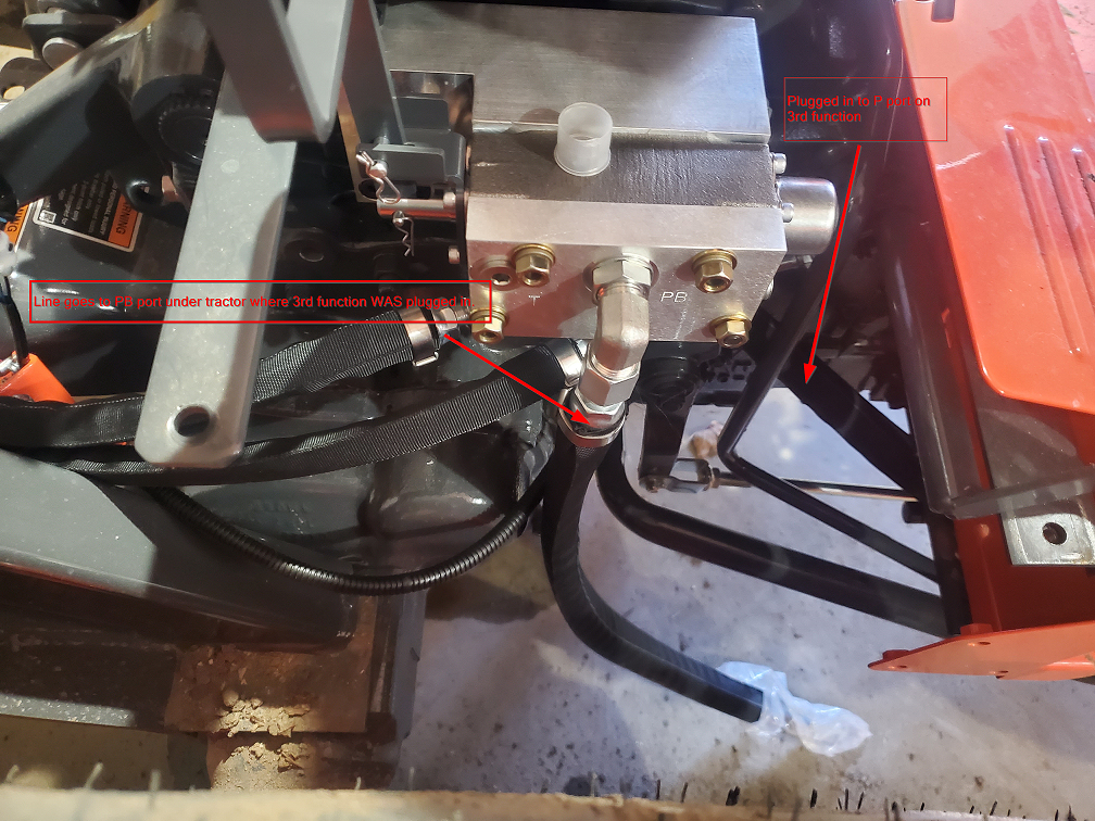

The kit numbers and contents have changed over time. The terrible instructions have not. AFAIK and from the pictures I have seen the kit for the L4701 is a different animal. It has a different connection to the side of the tractor and will not work on the other L01's. Here is a picture posted in another OTT thread. It is apparently the current flavor of the day for the L3901. The parts diagram is the L4701 version.
Lever kits:
  1. L7211B - first position, includes valve manifolds, first position lever, new lever guide plate, hoses, and one set of couplers with ROPS mounting bracket
  2. L7212A - second position, includes second position lever, hoses, and second set of couplers
  3. L7213A - third position, includes third position lever, hoses, and third set of couplers
Valve options:
  1. L7231A - 4 way, 3 position, spring center
  2. L7232A - 4 way, 4 position, float detent
  3. L7233A - 4 way, 3 position, self canceling detent
  4. L7234A - 4 way, 3 position, detent
