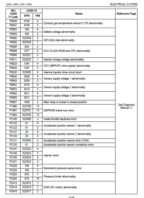

are you sure the code is P2294?
in the 3901 work shop manual that code does not seem to appear? (or I cann't find it)
If you re-check and find it is different, send me a pm and I will look it up in the WSM. That way I won't miss your response.
Sorry could not find P2294 it goes P2293 then jumps to P2413 in my manuals.
