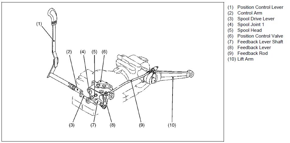

There is a feedback rod that needs to be adjusted, #9 in the image below.
Feedback Rod Adjustment
1. Set the position control lever (1) to the lowest position.
2. Start the engine, and set the engine revolution to idling.
3. Move the position control lever (1) to uppermost position.
4. While pushing feedback rod (9) forward, turn the adjusting nut counterclockwise until the relief valve starts working.
5. When relief valve starts operation, turn the adjusting nut clockwise 2 turns.
6. Tighten the lock nut as holding the adjusting nut not to turn.
7. Set the engine revolution to maximum.
8. Move the position control lever (1) to lowest position.
9. Move the position control lever (1) to uppermost position.
10. Check the relief valve does not operate. If operates, adjust the feedback rod again.
11. Measure the lift arm free play.
12. If measurement is not within the factory specification, adjust the feedback rod length.
* When lift arm free play is large, Lengthen the feedback rod (9)
* When lift arm free play is small, Shorten the feedback rod (9)

Hey thanks! I'll try to fool with this tomorrow. I suppose the relief valve is what is making the bind sound? Making it where the lift is slow? It's going into relief mode ?
Better put - How does one know when the relief valve is operating? (Probably when the lift is slow and the unit sounds like its in a bind?)
6,401
2,043
The squealing sound is what alerts me
