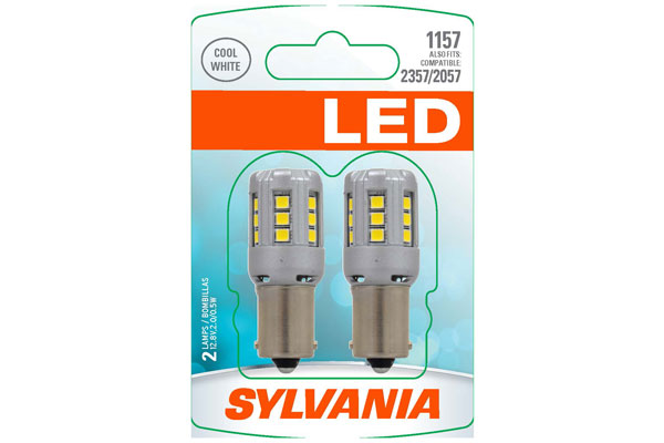

I upgraded my L3830 factory headlights, tail lights, and flashers with LED's. I really like the update, especially the headlights. They are 1,000 lumens each and a huge improvement over the incans. The P15D headlight bulb was replaced with one from Formula J87. I went with Sylvania 1156 and 1157's for the tail lights and deck and rear flashers. I also added a 900 Lumen worklight from tractor supply. I don't do alot of work at night, but I'm better prepared now.

If they are the push-in and twist type....look at the bottom...single pin should be a 1156...these were in my flashers. Double pin should be 1157...these were in my tail lights/brake lights. Advance, Auto Zone, O'Reilly has these in LED...see my video.
