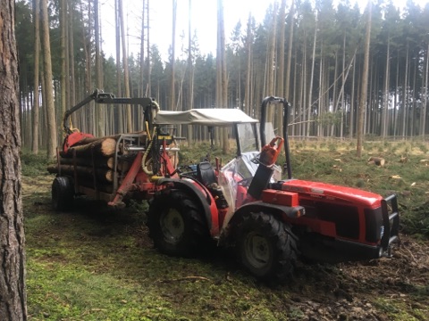

Hello,
It depends....
The lifting cap of the crane will depend on the pressure your tractors pump delivers, 160-170 bar would be ok,
Speed might be an issue though...
I had a Weimer 4100 crane used with a L5040, went well.
Traction depends on type of tyres, weight of you tractor, fully laden weight of your trailer, etc.
But more on degree of slopes,
How wet and how hard the ground is you want to pull the trailer,
In my case the bota was over its limits, i had to unload often again and pass over a racine, also because the ground was quite wet and my trailer has only one axle, as it is a transformed self loading fodder wagon, Mengele LW 20, which has a capacity if 4 metric tons, see photos.
Prob of the bota is the limited inclination of the front axle due to the douple angle drive system, my Carraro pulls by far better, this winter was extremeky wet with ni frist and u git all loads out if the forest without dven using the front nor rear diff locks.
An atv type or vahva jussy type trailer should be better, max 2-2,5 t
Enjoy it it is fun!
