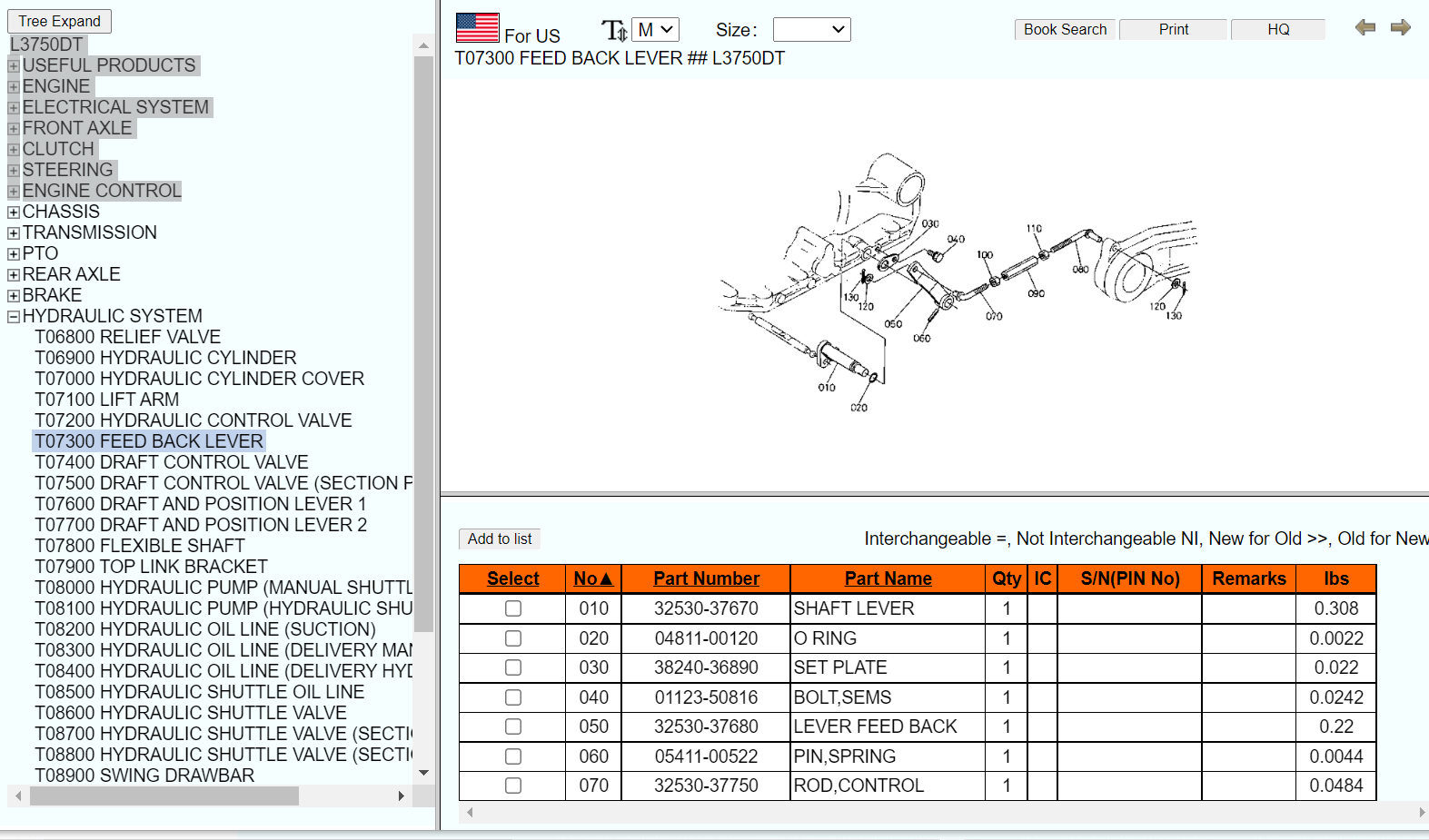

If you are hearing a pressure relief, wondering if the feedback rod could be out of adjustment after all those years without use?
I know the feedback rod can cause some funky symptoms if out of adjustment.
This is the illustrated parts diagram for your L3750DT.
I’ll check on that when there’s daylight again, thank you for the reply.

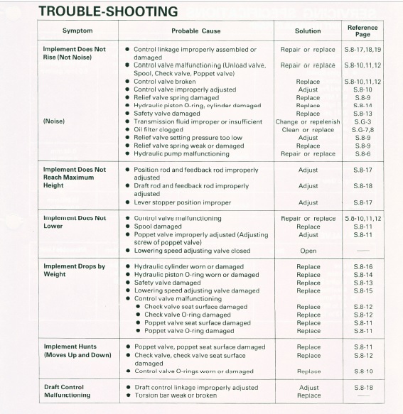

Here's a page from a workshop manual for 3-pt troubleshooting listing several possibilities.
