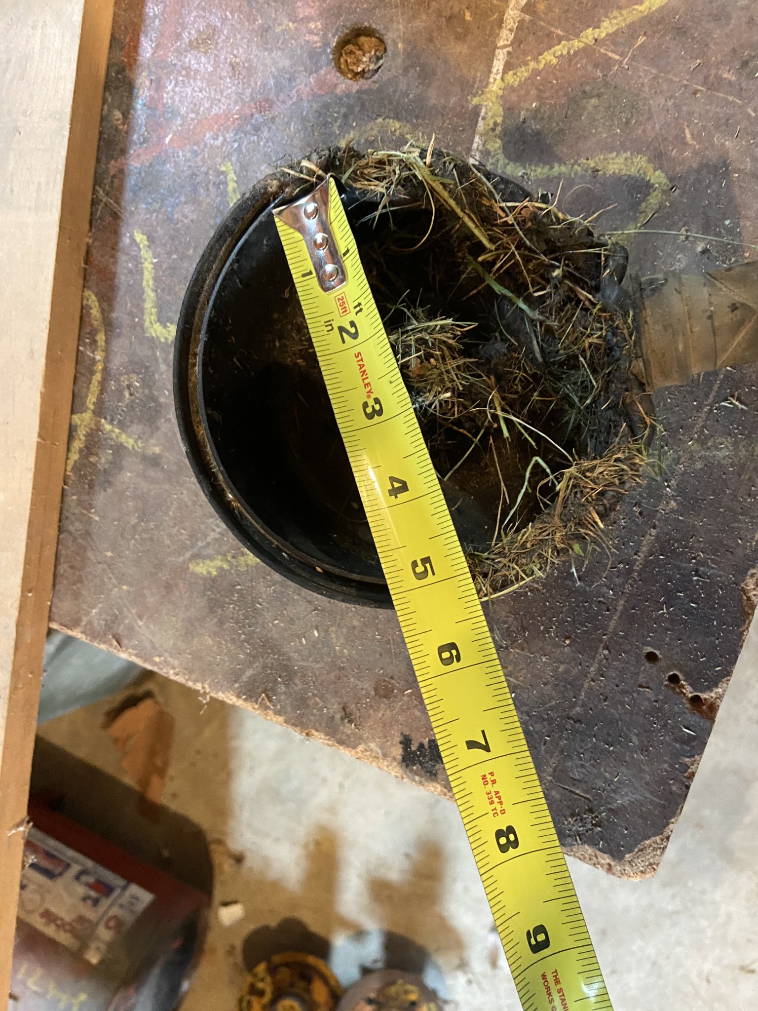

I just had a small fire in my Air Cleaner and it melted the air cleaner assembly and filter cap! A new one is very expensive. Has anyone adapted an aftermarket filter assembly in lieu of the OEM assembly? Thanks for the help!

I’m sure Donaldson has something. I’ve used them on some Toro mowers with Kubota engines at work. Take a few measurements of what you have and get to looking.

Thanks. I noted Donaldson came up a few times when I was searching for the filter assembly, I’ll give them a try!
I just looked up the filter for your tractor, looks odd. May have to replace the whole air box assembly with Donaldson. Might even get you into a less expensive dual filter setup.

Messicks wants almost $500 for the Assembly! I’ll give Donaldson a call and see if the have a suggested replacement!

Well it was not my finest hour that’s for sure! I had been cutting with the brush hog and accumulated a lot of grass dust around the radiator and air cleaner! Then we set a pile of brush/cut up trees on fire and after it died down I used the bucket to Push the brush into the middle and a spark from the fire got sucked into the air cleaner and that started the dust on fire! The Air cleaner assembly being rubber started to burn and here I am!

The housing is not that much at $140
The whole ball of wax is $450

I buy the air cleaner housings on Amazon. They have many of the original equipment Donaldson housing.
