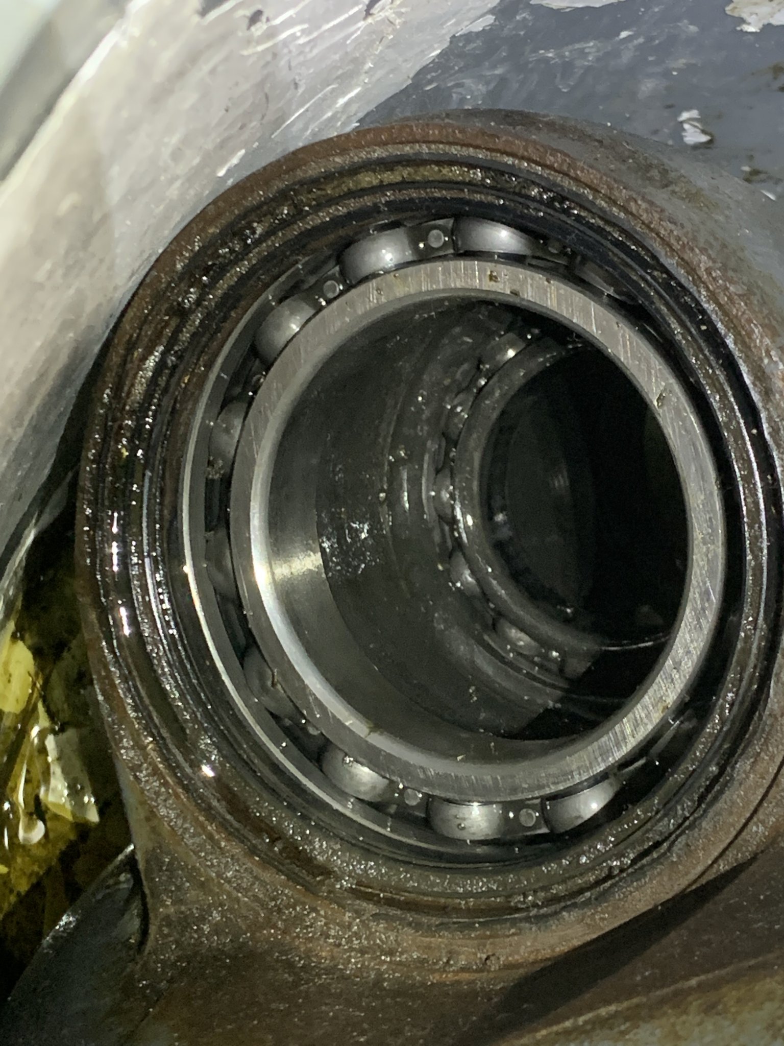

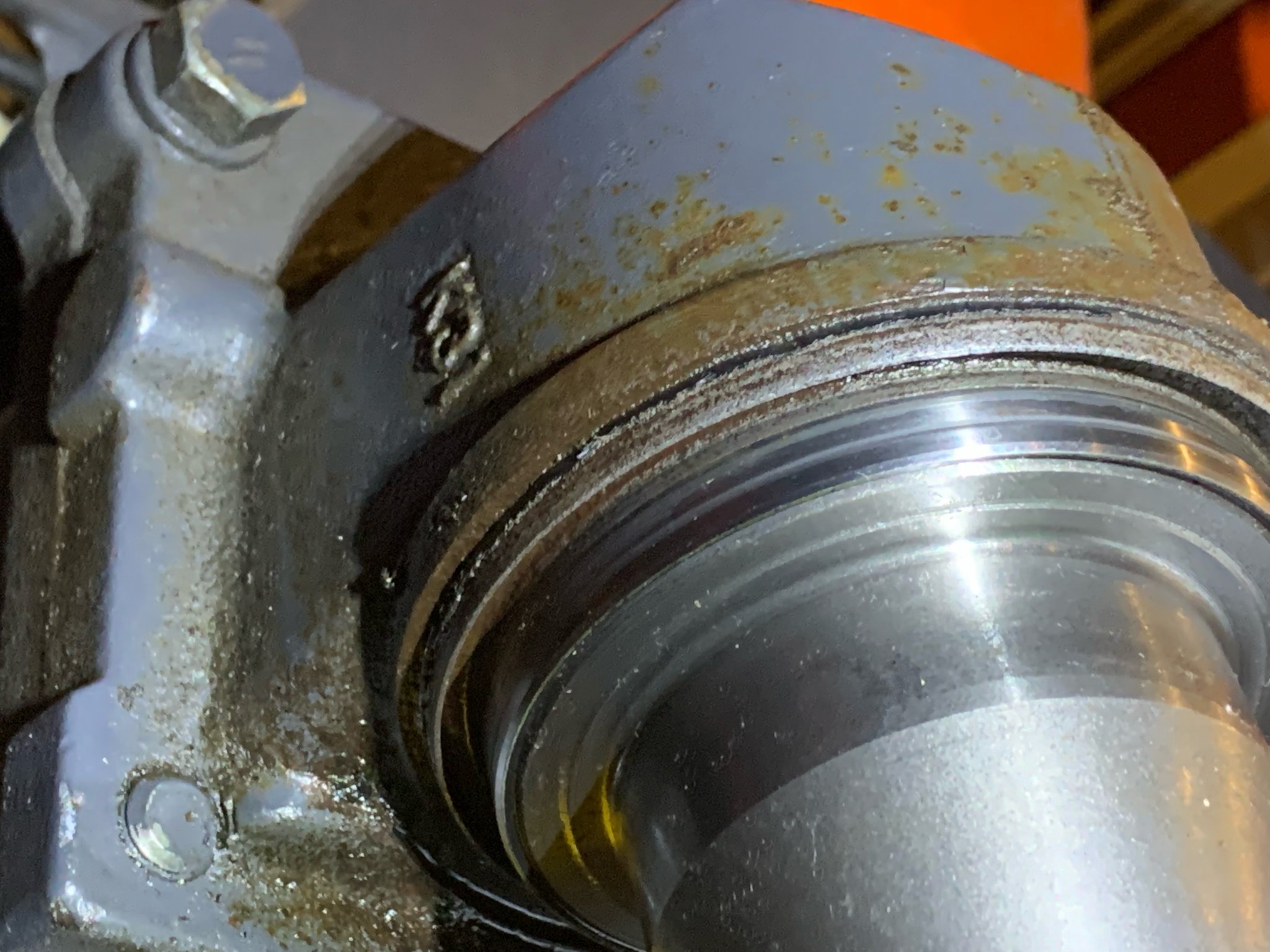

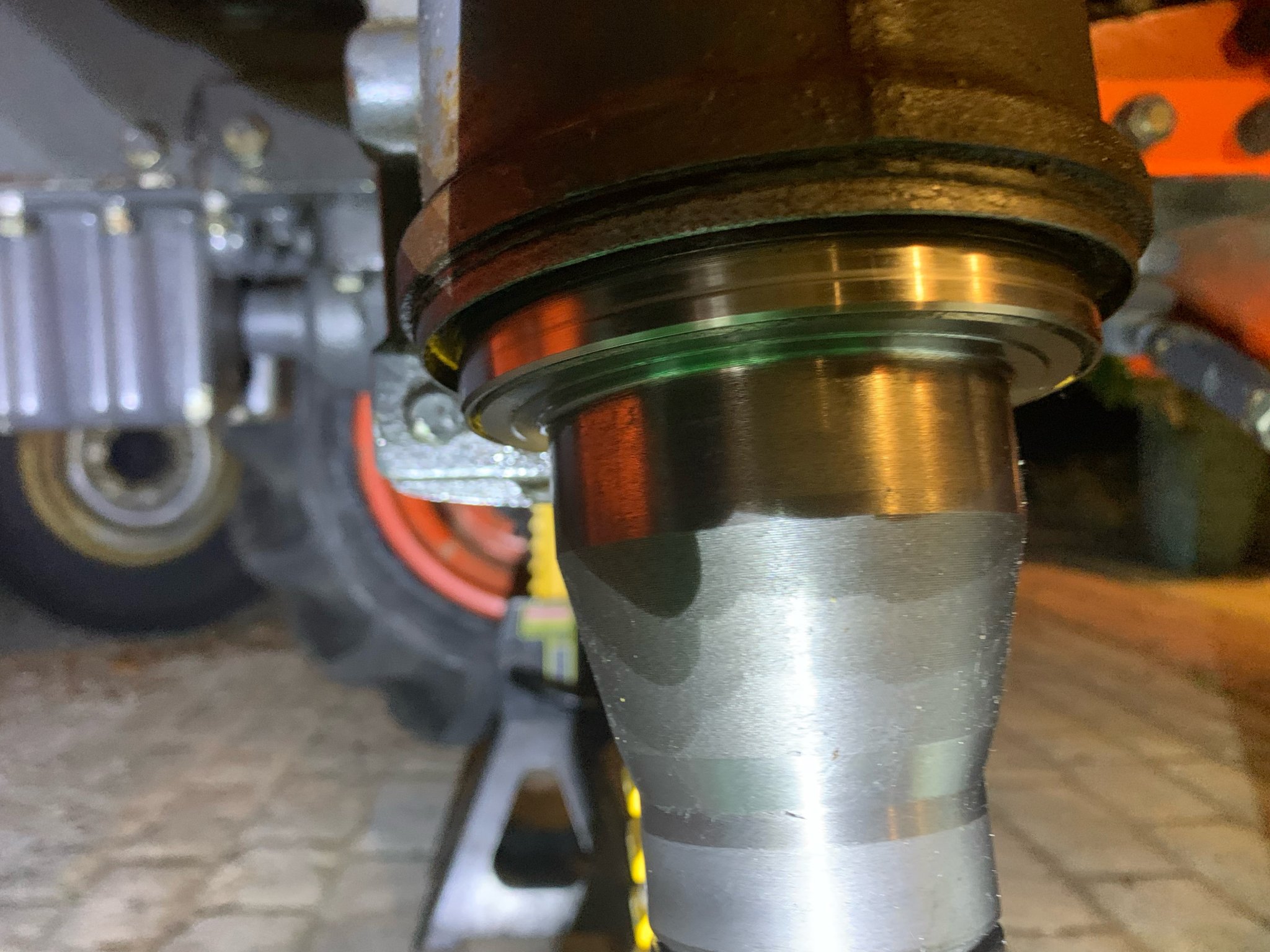

Must have changed the new seals within the last year.
Last one I did--oct 2020--they ship them as one piece (inner and outer are assembled together) but it's actually a two piece; you can take them apart.
Worth mentioning. When you remove the old inner, it'd be advisable to clean any corrosion/dirt/etc off of the kingpin, all the way up to the fillet, so that the seal will go on correctly and any corrosion under the seal won't cause it to leak.
