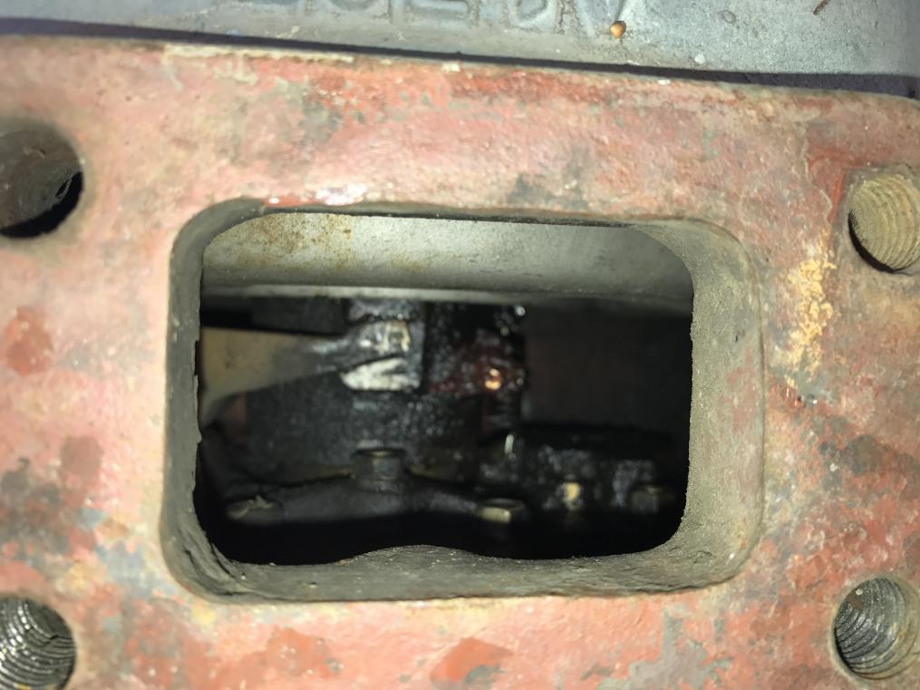

As stated in a previous poster, I inherited a mid 80's L355ss. Now I am trying to get it back operational. I seems like the clutch isn't engaging, so I look on the right side of the tractor and the clutch cover is off. So I am assuming my grandpa was having issues with it when he parked it. Can anyone lead me in the direction of servicing the clutch? Or attempting to trouble shoot what ever he might have been trying to trouble shoot. The tractor starts fine, but does not engage when I let out the clutch. The hydraulic fluid looks good. The SS seems to be working appropriately.

Might be worn clutch pedal linkage. Also, its hard to tell for sure but the release fork 6 and the hub 10 look worn in the picture. They only move a small distance so wear affects whether they work right. Another common thing is the hub gets stuck (lack of grease) and doesn't move as it should. Is the hub moving back and forth with the pedal? If its stuck maybe it can be freed up with penetrating oil and moved with a prybar helping the linkage?
If the clutch isn't engaging when letting up the pedal, what leads you to believe the F and R shuttle clutch packs are working ok? Is there pressure at the control valve (under the fuel tank)? It gets oil from the priority valve under the seat.

The hub does move back and forth when pushing the pedal. To be honest I don't know if the F and R of the shuttle shift is operating correctly. What is the best way to rule that out?

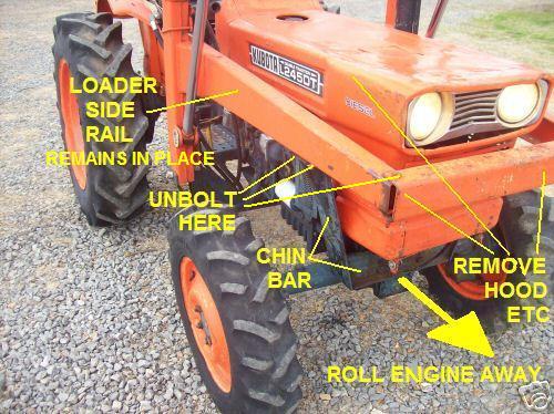

The 1720 loader is the non-detachable type, so it's easier to leave the whole thing attached to the tractor. See marked up pic.

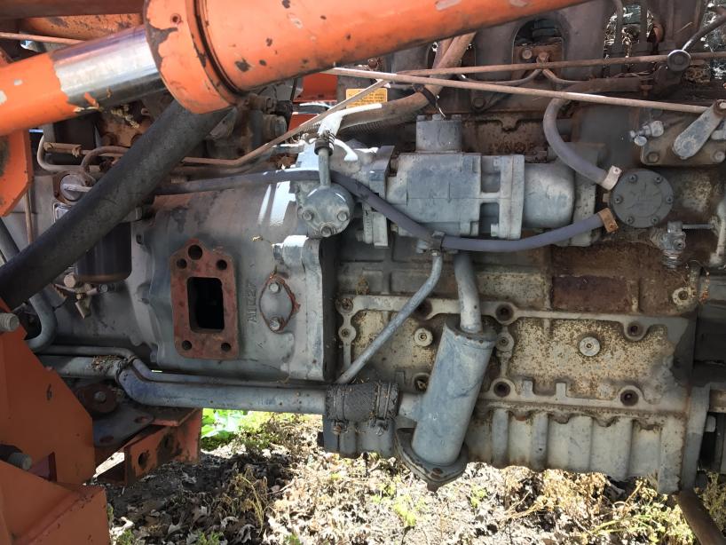

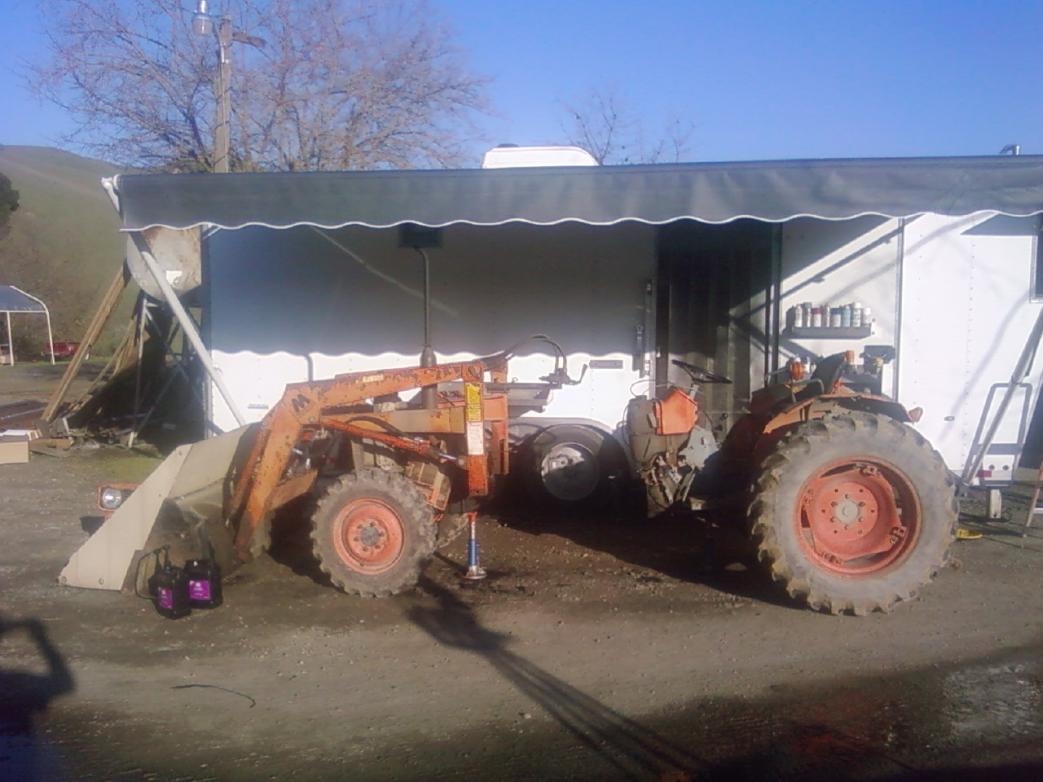

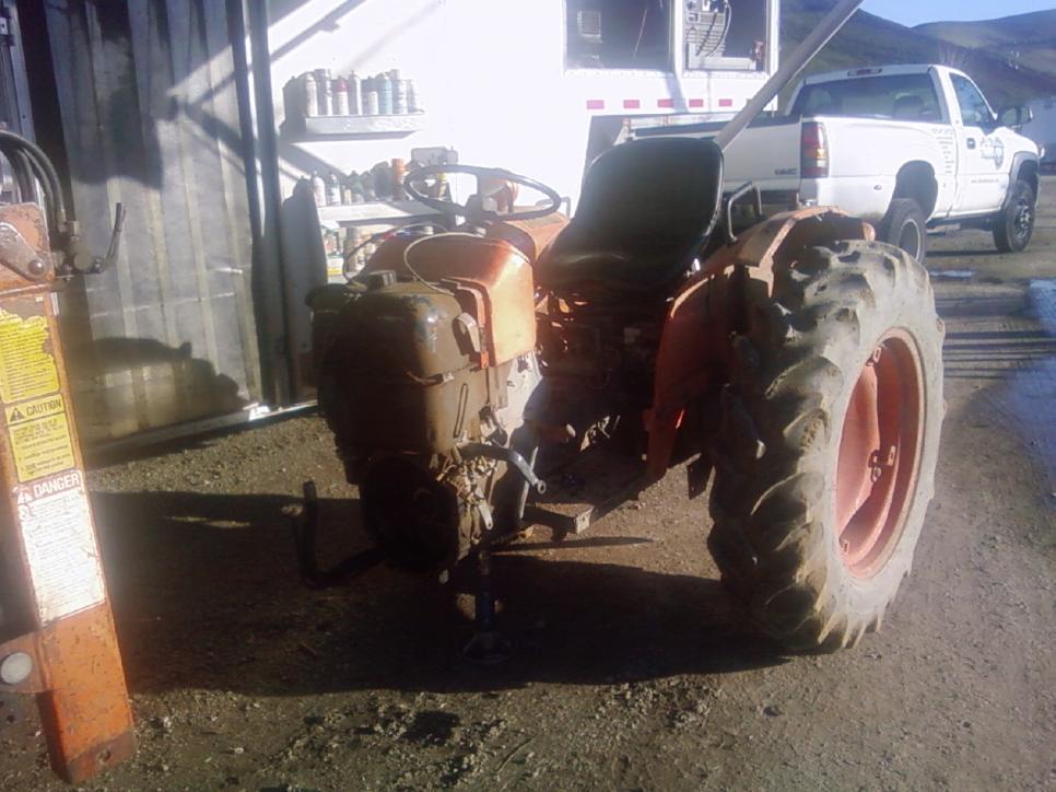

To split the machine, first take down and remove the front driveshaft. The loader can remain in place, either lowered or raised and blocked with wood posts from the side rails (more working room). Drain the transmission oil, unbolt the loader's chin bar from its side rails (leave chin bar in place), take off the hood, disconnect the steering link, hydraulic supply pipes, unbolt the braces to the radiator, unplug/disconnect wires, speedo cable, etc., support both halves on rolling jacks, take out the bell housing bolts, and then roll the front half away from the rest of it. If it hasn't been apart before, you may need to drive pointed tools into the seam to get it started. The split works best on a level flat floor, and if you visualize it for a while first. Pics below are other models, done over dirt, but give the general idea.
The loader and tractor halves are heavy - so go slow, plan your moves, work safe. Post what you find in there.

I was able to split it apart and replace the clutch. Unfortunately the old clutch looked fine, and replacement did not change anything. We opened and cleaned the flow control valve, the plunger appeared to be stuck but did not change the outcome.
I am in the process of making an adapter to test the pressures at the shuttle shift (probably what I should have done first). Oh well, live and learn.
