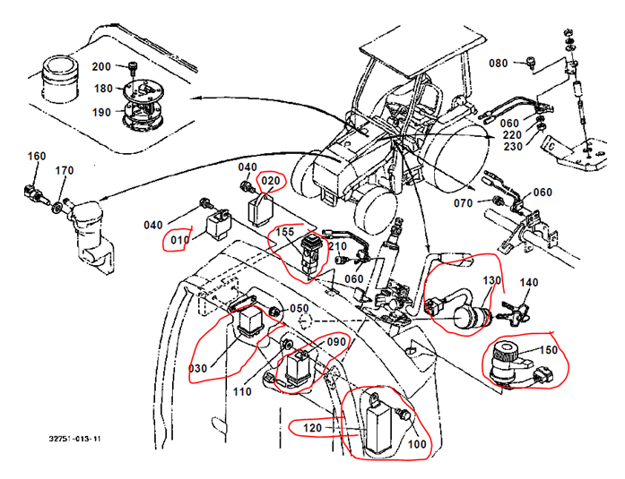

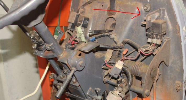

PoTreeBoy I have a new Key Stop Relay/Timer, but don't see how to gain access to it's mounting position. I'm unable to remove the instrument panel or plastic shroud. I hope you can give me a clue. Thanks for your time and assistance.
Nicksacco
Kubota L35 TLB, 2014 RTV-1140CPX
Sep 15, 2021
756
487
Bahama, NC
The Key Timer is located on the right side of the control panel behind the instrument panel.
See the FIRST drawing - it is number 010.
In the photo, it's location is shown by the arrow.

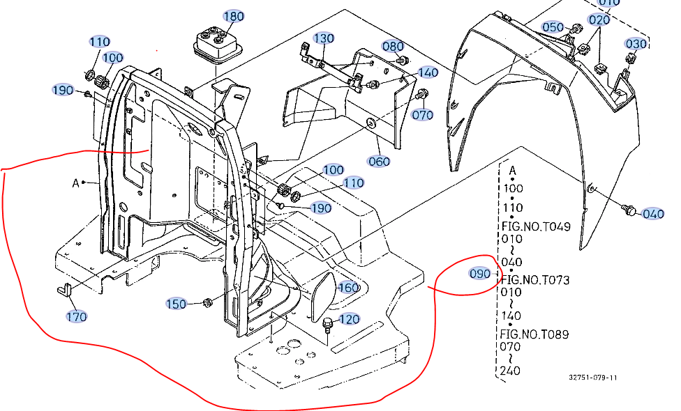

Drawing 2 shows the panel
When you say: " I'm unable to remove the instrument panel or plastic shroud", what does that mean?
