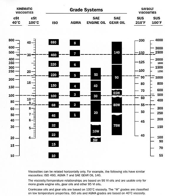

I need to change the transmission fluid on my L345DT. The manual I have says SAE80, but that seems a bit thick for the hydraulic system. I have seen posts suggesting Kubota UDT which I can't get here, and another website suggested "tractor hydraulic oil". Does that mean ISO46 or ISO68?

I've got an L245 and just changed mine this weekend. I too looked in the manual and found 80W listed. I thought that sounded thick but I checked a viscosity chart (attached). The universal transmission fluid (UDT) has a Saybolt viscosity @ 100F of 400 which correlates to an 80W gear oil. Interesting. I also checked with the dealer and they recommended a UDT. So, I traipse off to my TSC and gather up 26 quarts. I drained from both transmission ports, and both final drives. A lot of oil! I then removed and replaced the filter screen and o-ring. All is well in my world....I thought.
