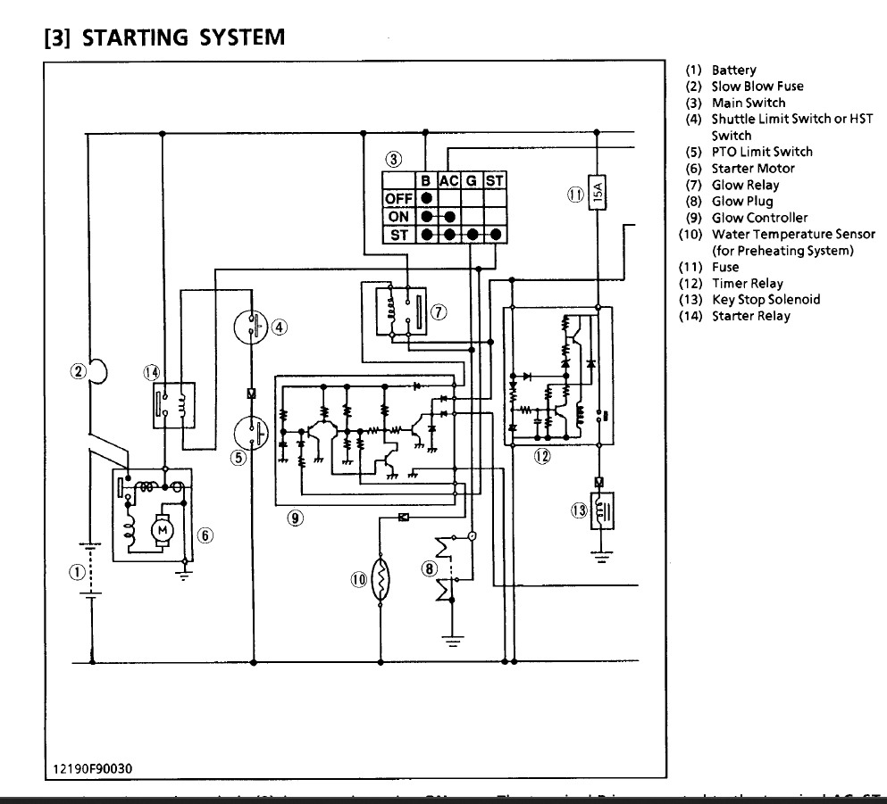

Follow the WSM, it's a pretty easy thing to chase on that model.
WSM's here:
If the main starter switch is putting out the start signal, then it would go to the hot side of the start relay coil.
The ground side of the start relay coil goes to the shuttle switch and then the PTO switch then to ground.
There is probably a fuse on the start relay feed line.
