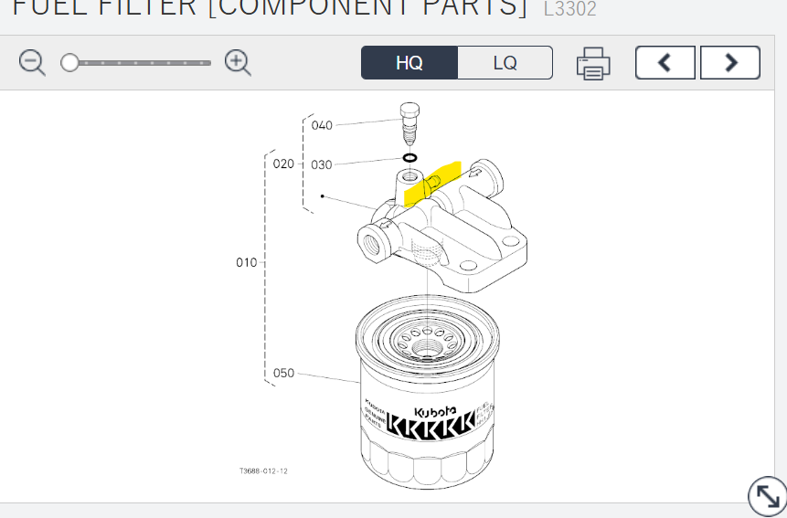

Are you getting fuel out of the top of the fuel filter bleeder?
Yes, absolutely. Fuel makes it past that to the common rail high pressure pump.
