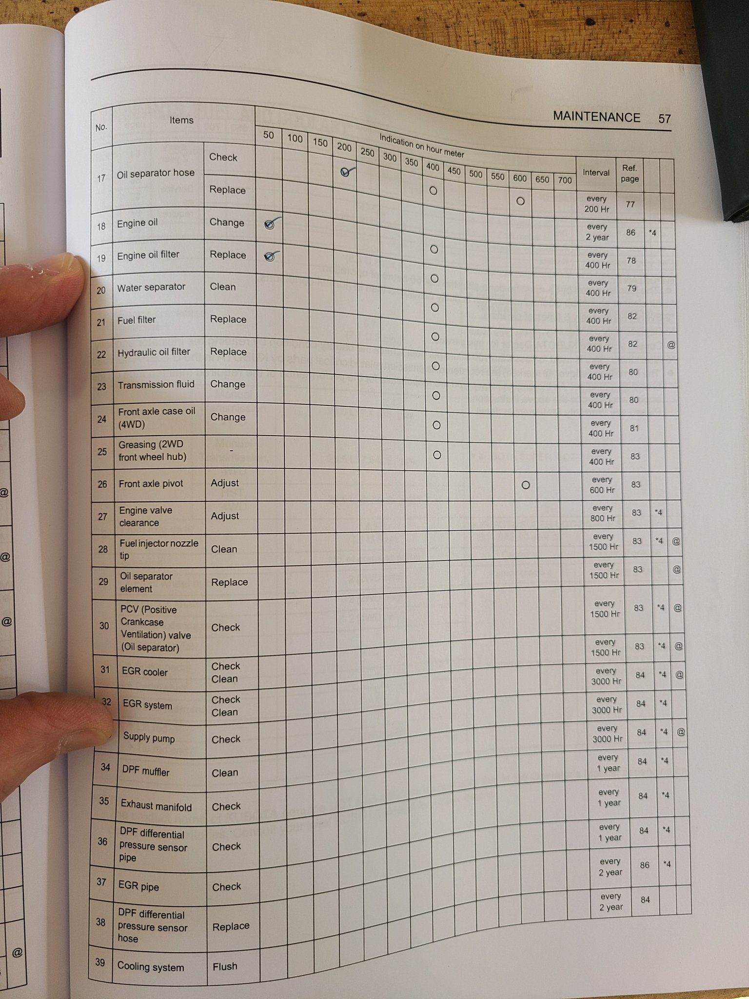

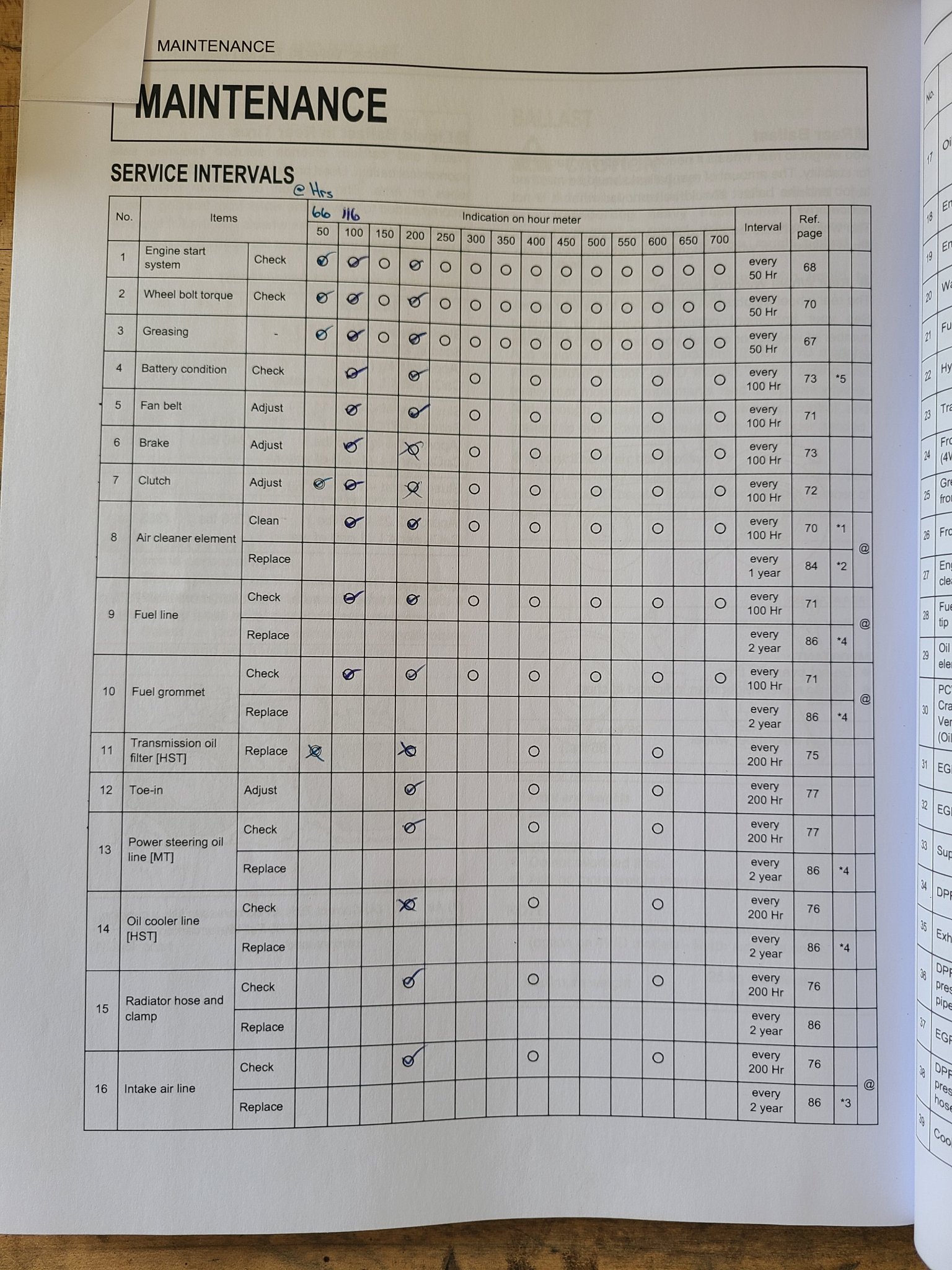

I thought the original filter (painted gray at factory) was to be changed at 50 hours??? Fluid is fine to wait till 400.
I just double checked my service manual, and if you have a HST then there's a 50 hr filter change, but if gear drive transmission then filter and fluid both get changed at 400 hrs.
10,174
5,459
Just checked again with the 3ph lever all the way down and the loader and steering are still gutless. Bumped the rpm up to 2-2500 rpms and nothing changes other than how loud the rattling noise is.
You are probably going to have to check for flow and pressure at the hydraulic outlet block. Do you know how to do that?
10,174
5,459

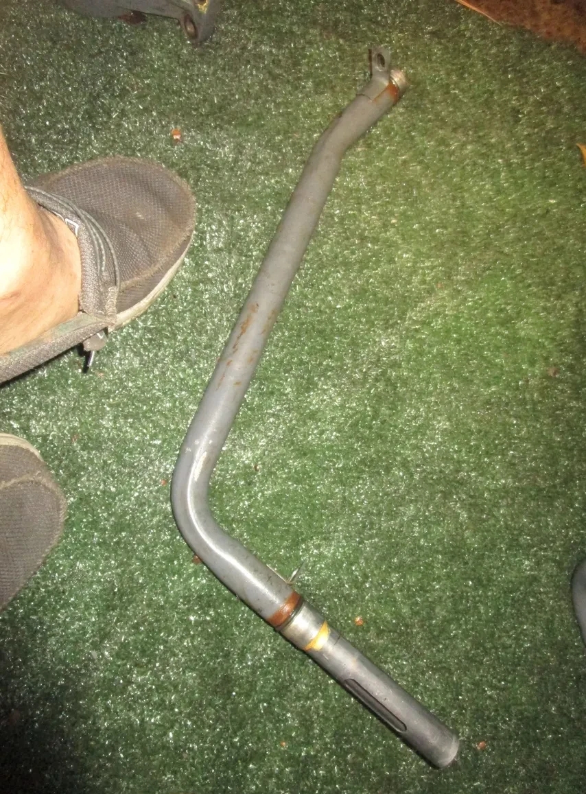

I just rediscovered an old thread with this exact same model and problem. It turned out to be a clogged suction screen on the pickup pipe. It was starving both pumps. I had completely forgotten it existed.
Plan on changing the oil because it has to be drained before you remove the tube.
10,174
5,459
Dan, do you have the link to that thread? Please and thank you.
I cant seem to find it now but was early 2024.. Nothing there we have not already covered. I went down the same rabbit holes with him and no luck untill the guy mentioned the screen. I did not know it existed but he removed the pipe and posted that picture. Cleaned the screen and bingo!
33,708
8,918
