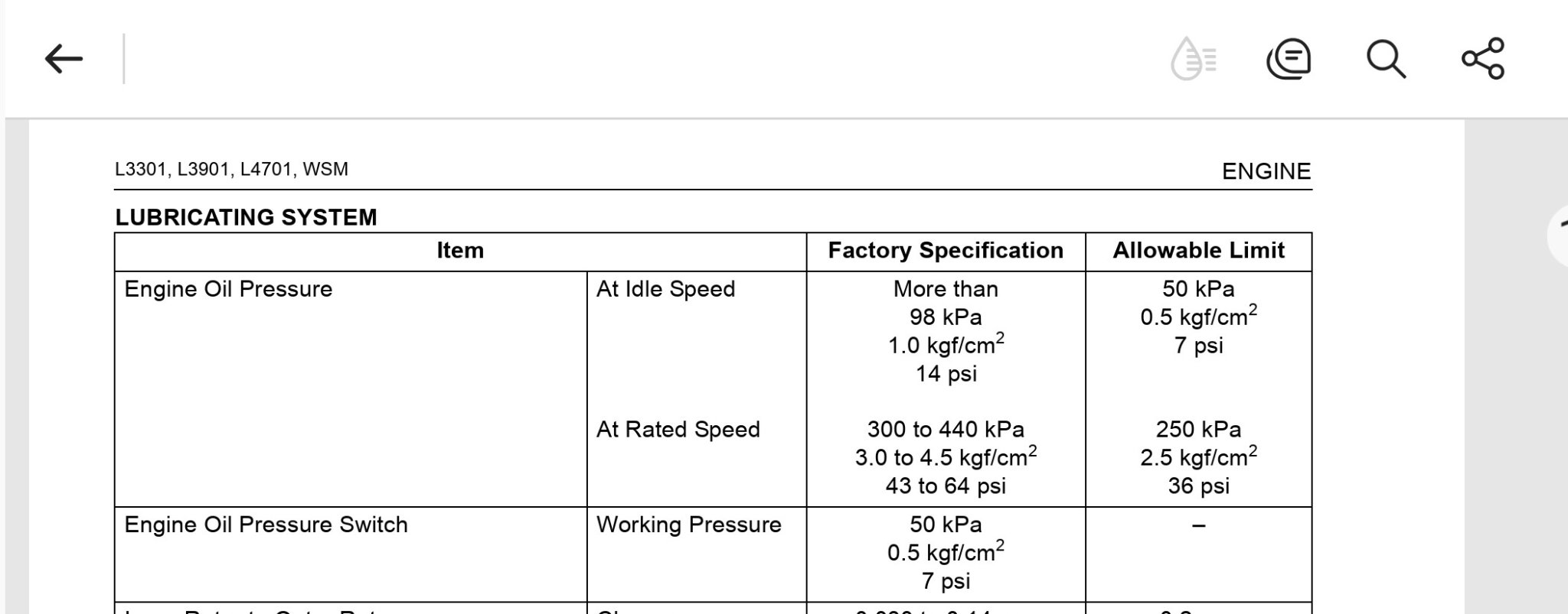

The WSM is quite clear - minimum allowable oil pressure for that engine is 36 PSI @ rated speed.
Hokie… you yourself posted the chart which allows 7 psi at idle. My comments were not referencing Kubota WSM… they were anecdotal for purposes of reassuring the OP’s concerns.
And my response was to your 'anecdotal" claim that 20 PSI was adequate for everything but race cars. Its not and never has been.
