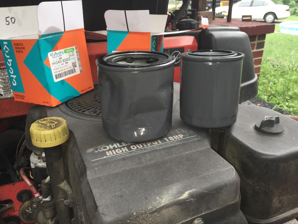

I have read a lot, in this forum about changing a HST, or transmission screen when you change the HST filter and transmission filter. Does the L3301 actually have this evasive "Transmission / HST Screen," if so where is it located. I cannot find any information in my operator's manual, therefore if anyone can enlighten me, it would be greatly appreciated. I have changed both filters, but could not find a screen to clean or change.

I am thinking that is on the B models. Dad and I have a L3700SU and a L3800HST and as far as I know these or the 3301s,3901s do not have them. Looks like you found all there is one filter under left and one under right floorboards. Be sure you have a magnet on the one under the right floorboard.

Thank you so much for your reply, and reassurance . . . and yes, I used the correct Kubota filters from the dealer for my application.
