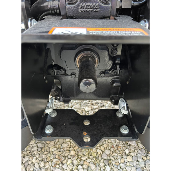

Hello,
I recently bought a L3301 that has the 3pt speed adjustment valve froze. The tractor had 570 hour on it. From the looks it did not look as if the 3pt was every used. Paint is fresh and still had the plastic cap on the spindle. The hitch goes up and down. I have been shooting PB blaster on it for a while. I removed the Knob so that I had access to it. The angle is tough to get a good grip on it with vice grip or pliers. I found an Allen wrench that fits the hole the cotter pin used for the knob and have tried to use that to work the valve. I have a shop maintenance manual and looked at hole it is built, figuring if I want to try and pull it out to rebuild it. Any thoughts? Should I just leave it alone since it works. I have a boxblade and a flail mower and a ballast box that I use with it. It goes down moderate. Thanks

Sorry for any confusion. The 3pt. PTO had a plastic cover on it when I purchased it. Everything on the 3pt are looked as if it was never used. I used attachments with it. They lower at a moderate rate. I was checking things out and noticed that the 3pt speed control knob is frozen.

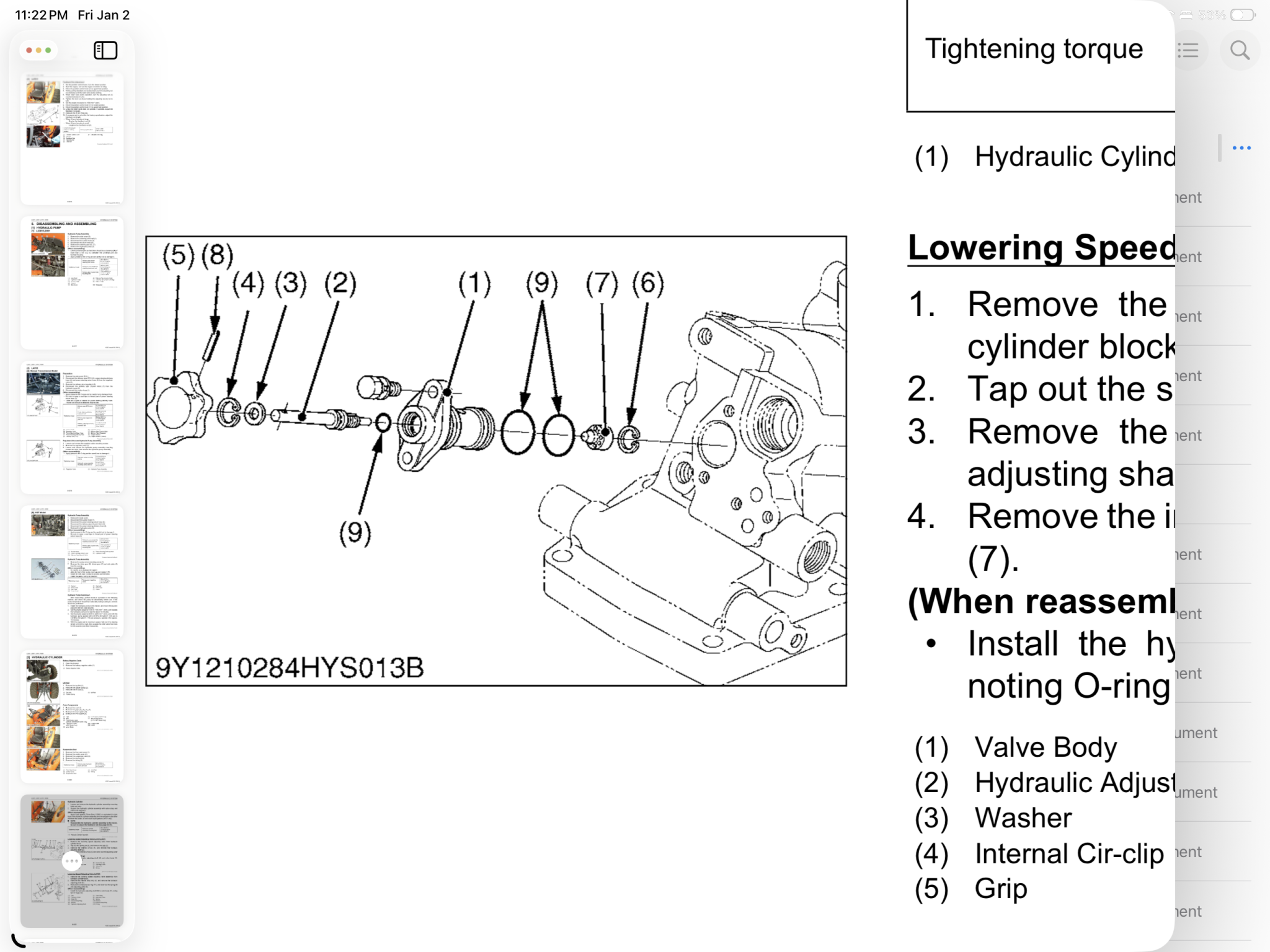

That one is easy to fix.
Lower three point to full down.
Remove E clip #080 (Yellow) and pull valve straight out clean and replace.
If that doesn't work
Then remove 2 #110 screws (green)
Pull entire valve strait out.
Get it on a bench and clean and disassemble clean interior and reassemble.
Then replace entire valve assembly.
