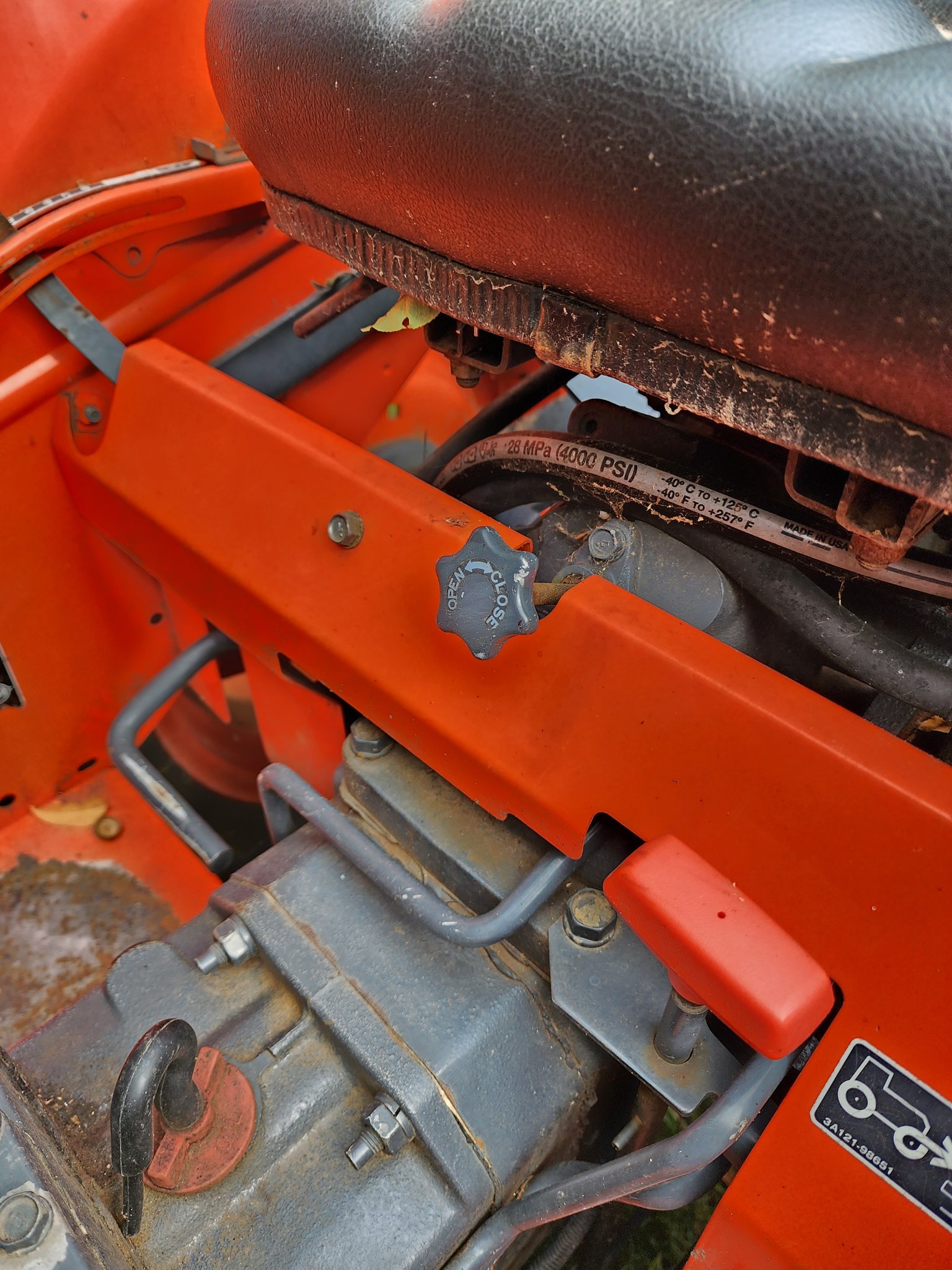

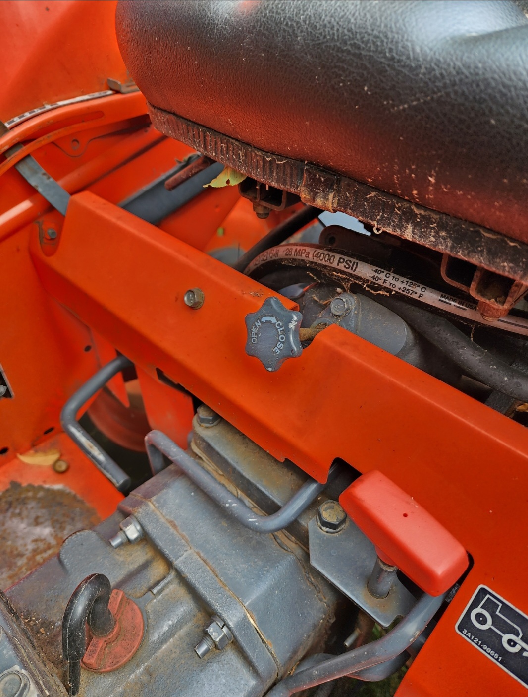

M MamkubotaL3300DT New member Equipment L3300DT Sep 26, 2023 1 0 1 Michigan Sep 26, 2023 #1 Bought used. No manual. Valve in front of and below seat labeled open or closed. Seized. What does it do? Everything works? Attachments 20230926_133758.jpg 494.3 KB Views: 100 Screenshot_20230926_164003_Gallery.jpg 419.1 KB Views: 98 Screenshot_20230926_164003_Gallery.jpg 419.1 KB Views: 95 Screenshot_20230926_164003_Gallery.jpg 419.1 KB Views: 97 Screenshot_20230926_164003_Gallery.jpg 419.1 KB Views: 90
06B3030 Active member Equipment B3030, LA403, BH75, York Rake, Plug Aerator, 6' Rear Mower, Forks, Weight Box Sep 21, 2015 170 226 43 MA Sep 26, 2023 #2 3PH Valve
North Idaho Wolfman Moderator Staff member Lifetime Member Equipment L3450DT-GST, Woods FEL, B7100 HSD, FEL, 60" SB, 743 Bobcat with V2203, and more Jun 9, 2013 30,552 6,600 113 Sandpoint, ID Sep 26, 2023 #3 Three point drop speed
GrizBota Well-known member Equipment L3830HST/LA724, B2601/LA435/RCK54-32, RCR1872, CDI 66”grapple, pallet forks Apr 26, 2023 1,153 736 113 Oregon Sep 26, 2023 #4 There was a post on this last week. Mouse milk and WD40 said to have worked to get it loose. Reactions: 1 user
