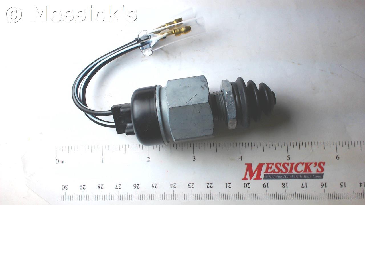

Are you certain when you say this....... look on Messicks for this particular tractor, after selecting the model, then enter the word "switch".
Apart from the ignition switch, only one comes up.
Switch
But perhaps you know this particular model very well..............
