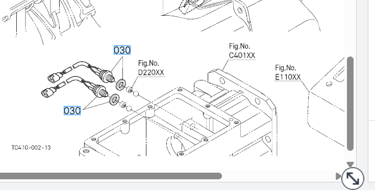

The switches for the transmission do not look at anything external they look at internal.
Your going to need to use the WSM on how to test the switches.

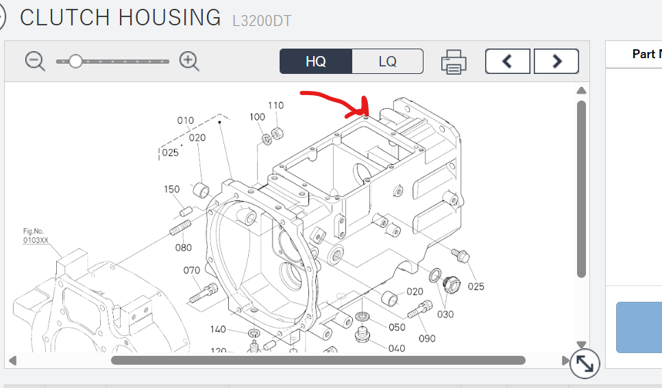

I do have the WSM but what page number did you find those drawings on? Your picture specifically references L3200DT whereas mine does not.
