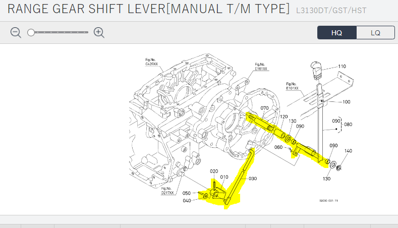

What tractor is it, DT, GST, HST?
All three have a range.
34,137
9,323
Check all of this linkage for wear or bent parts.
