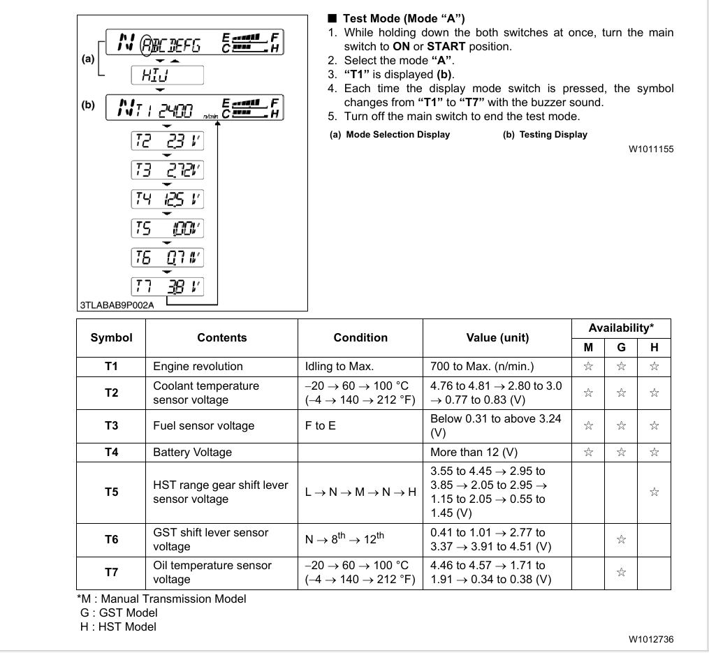

Tractor will not start, while going through the sensor test in mode A on the Intellipanel I notice that when I get to T6 which should display the gst lever sensor voltage I get 0.0v. Are these common to go out?

going to the gst sensor, I do have 5v on the red wire and the voltages varies on the white green when moving the shifter. But does not seem to register or make it to the Intellipanel

I checked battery voltage and it is good. Removed and cleaned battery ground and two others with no change. I did notice while in the Intellipanel mode A it would go T1,T2,T3,T4, skip T5 as expected for being a gst but then go T6 reading 0.0v and skip T7 and go to T8 reading 0.0v. What sensor would T8 be and why would it skip T7
Check the Mode I and see that it is set to "G", not "M".
T8 is probably a factory only Mode.
