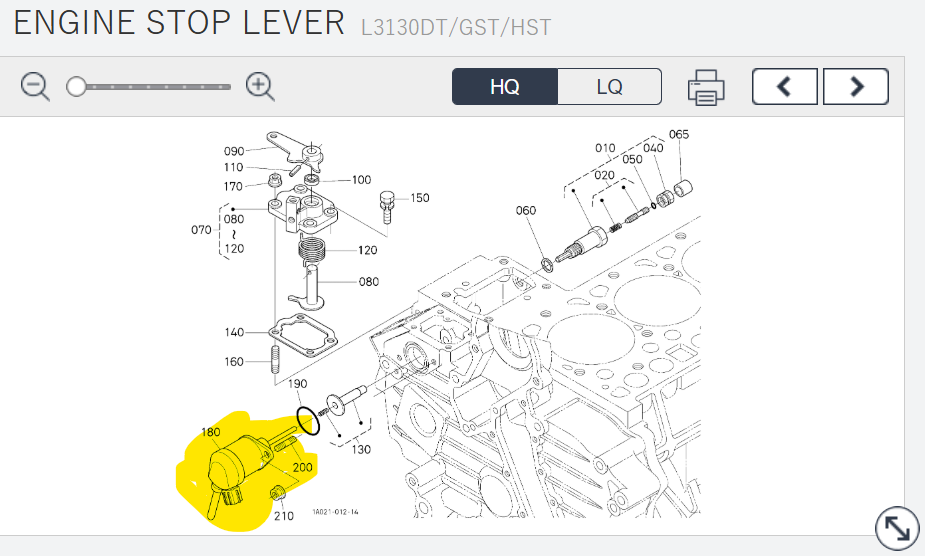

What you described sounds like it could be the shut off solenoid (that failed) that is near the injection pump.
I think you can remove it and increase the throttle position and start the tractor. Then you will have to manually shut the tractor down so you need to know how to do that before you start it!
I have been digging through drawings to find it and it looks like it’s made into the injection pump. It sounds very strong when you engage the key to the start position. I can feel the thud in the injector pump when the key goes to start as well.
I am not sure how to bypass it for testing.
34,502
9,749
Throw the ether/ starting fluid in the trash can and I hope you haven't damaged the engine.
Next pull the stop solenoid off the engine (yellow), if it starts you have either a problem with the start solenoid or one of 2 circuits that feeds it.
The stop solenoid has 2 coils in it one is the pull in coil and the other is the hold coil.
If either isn't working it wont start and run.

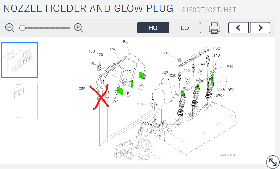

The other issue would require you to bleed the air out of the injector lines.
You do this by loosening the lines at the injectors not the injector pump.
Also you need to make sure you are actually getting fuel to the injection pump.

We chased things around with a meter and did not see any broken safety, loops or circuits. We went back to the beginning and started chasing fuel issues. We started and removed. The fuel cut off from the injector pump like instructed above and that did not help the problem. We could see that it was actuating as it should. We then started. At the injector and we were not getting fuel to the injectors. We started at the tank and worked each fuel on all the way to, and then through the injector pump to the fuel line going into the cylinder head.
We confirm flow through each line and make sure that we had good diesel going in the end. We put it all back together and then re-prime the system and it cranked and is running better than it running in years.
