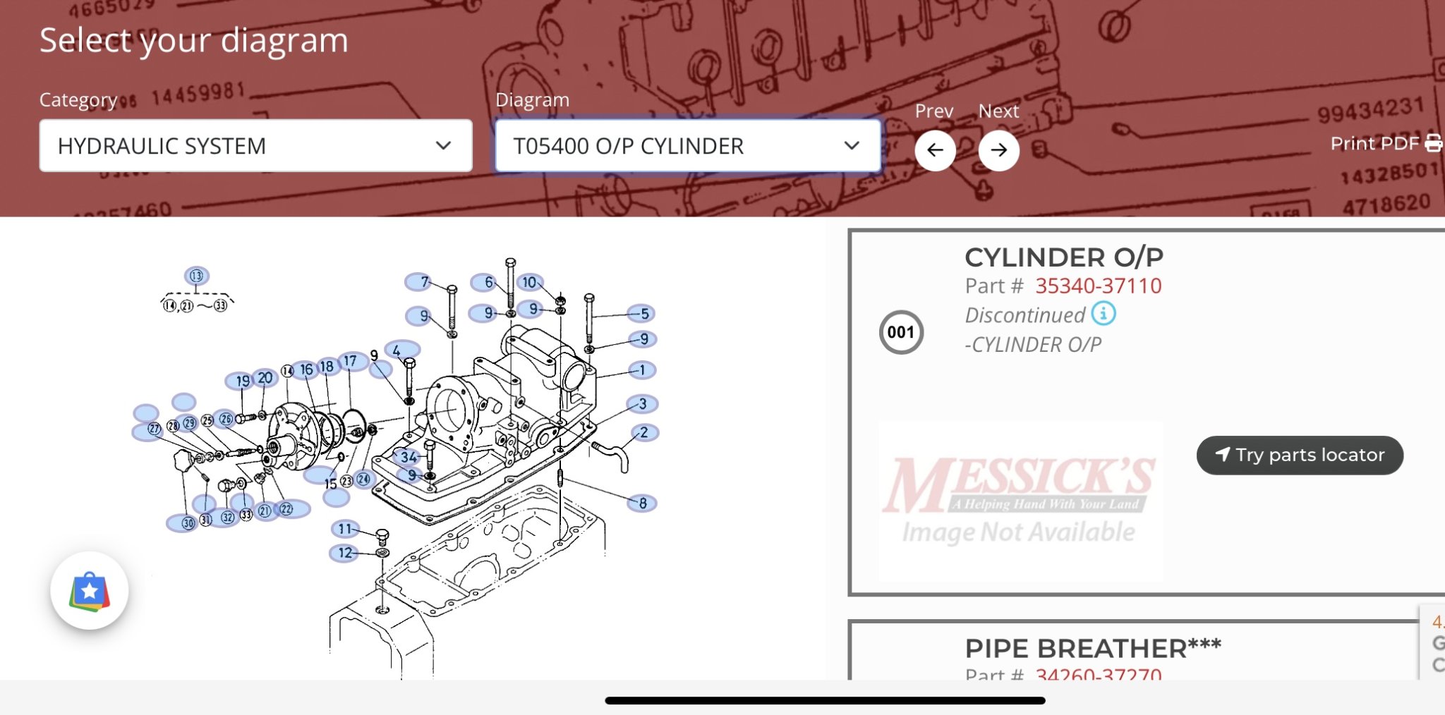

Answer is NO as far as I can tell.
The Messicks website has the part number as 35340-37110 for the L305 and for the L260 it is 32240-37118 for the large cover under the seat. There is a small cover on front that the lower speed knob is in. But they don’t show a part number for it.
You can call a salvage yard in California that may have whichever part you need

I am repairing. Customer broke knob off and valve rod off. It is screwd into plate and I cannot get it to turn out of it. Typical easy out has broke off. And I have tried several places and that is one I have found for the 200 series but not one for the 305. Do you have a good phone number for used parts
