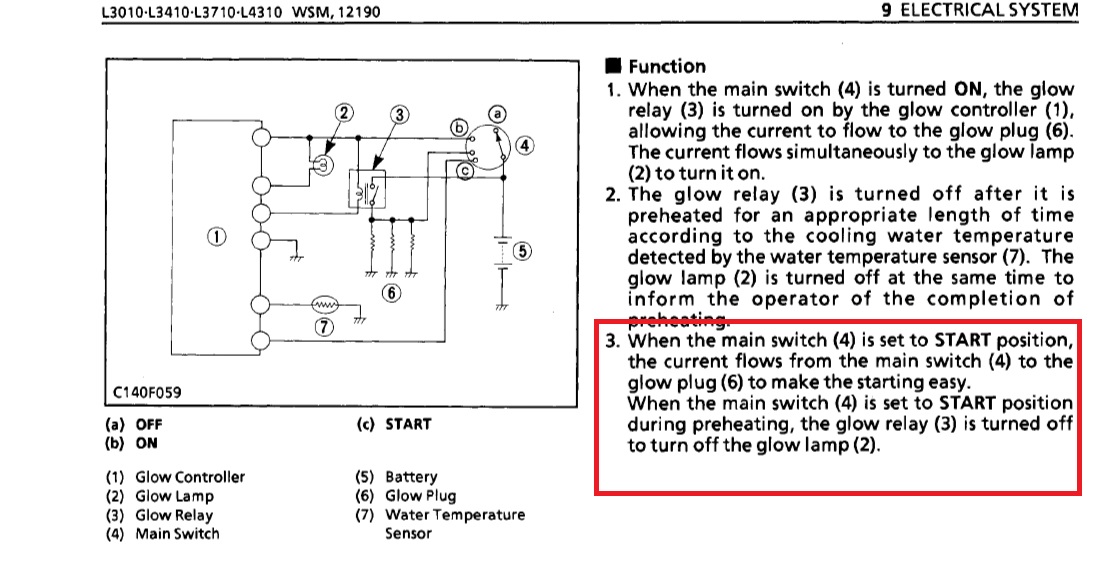

I have attached 4 pages from the WSM dealing with investigating the starting system.
Also below the schematic and operational description of the GP's
Note on this tractor the glow relay's main function is turning on the Glow lamp during pre heating otherwise in the START position the key switch send power directly to the GP's without using the relay.

Mystery solved (probably). Tested the start relay again with a 12.5+ V battery. This time instead of a loud snap & closed contacts I got a very quiet click & the contacts stayed open. Time to send some more $ to Messick's.
Thanks all for your help on this.
Russell: Thanks for the lesson on glow plug operation. It never occurred to me that the glow plugs would be activated even if the temperature isn't calling for much preheat. Guess that explains the voltage drop when the key is at start.
Dave: Thanks much for taking the time to lookup & post the pages from the WSM, and even highlight the part I was missing!

On those tractors the glow plugs should be activated when you first turn the key to "on" (run) position, and then should shut off pretty quickly. It is dependent on heat. There is a temp sensor up by the thermostat that tells the glow controller how hot the engine temp is. If it's cold, up to about 15 seconds. If it's warm, as little as one second. The glow controllers are known to fail on these, as are glow relays. Typical complaint is usually glow plug lamp stays on after starting the engine, or occasionally it just won't start when cold (no current flowing to glow plugs).
Russel is right, also when cranking the glow plugs should be activated.
When the glow plugs are active your battery voltage is going to drop off. They pull a lot of juice.
