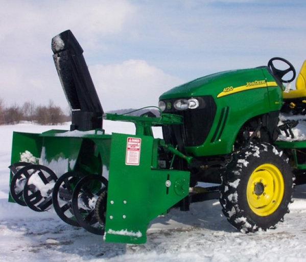

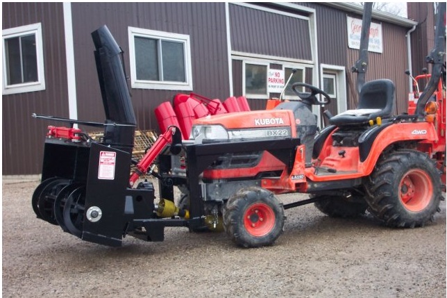

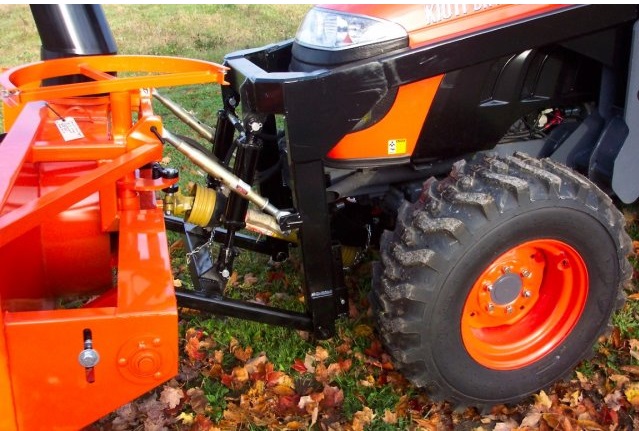

You might have excellent luck on a Canadian web site of Smyth Welding,
https://smythwelding.com/Snowblowers/adid/13471320/Smyth-Welding-Front-Mount-Kits
They are small enough to custom make front mounts for almost any tractor + they use serious style blowers with a true gearbox not the worm gear style found on most front mounts.
I have attached some examples from their site.
I had some serious discussions with them regarding a friends B7100. The Kubota front mount parts, although listed, were no longer available.
I think the price was around $5,000 Canadian.

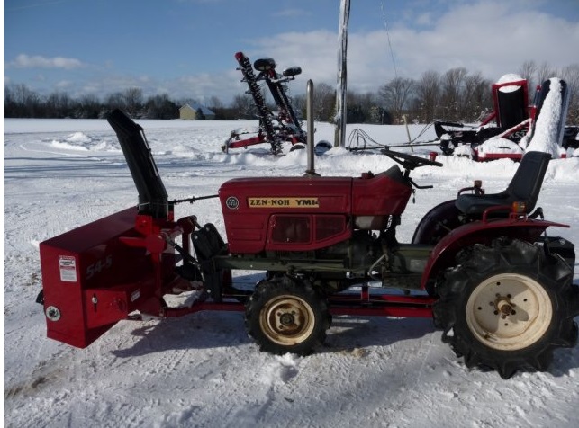

Yet another option would be a SSQA selfpowered blower. While commerically ones are available($$$), I'm 'frugal' and making my own.Picture 2 - 24" walkbehinds bolted together,powered by one 14HP engine.
I priced K/LP front mtd blower for my BX23S and got sticker shock(5K) BUT the main reason to make my own was to use the Quick Attach system. Once a PTO driven blower is on, it's on for the Winter...so you can't use bucket,loader,forks,etc. Well, NOT easily !!
I'll have less than $500 Canucks into it when done and it makes for an interesting project.
