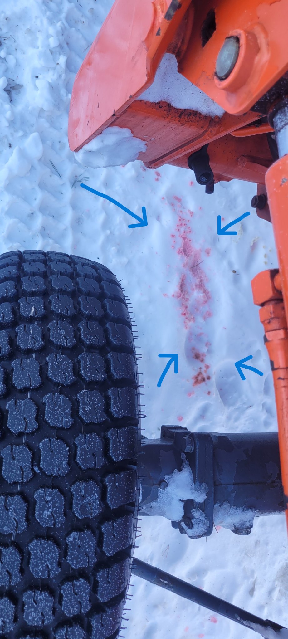

Currently the tractor is leaking hydraulic fluid from the left side of the 3pth, from the pump, and from somewhere up front (I can see drops of fluid on the snow on the steering knuckle, but not sure where its from - maybe a line to the loader?).

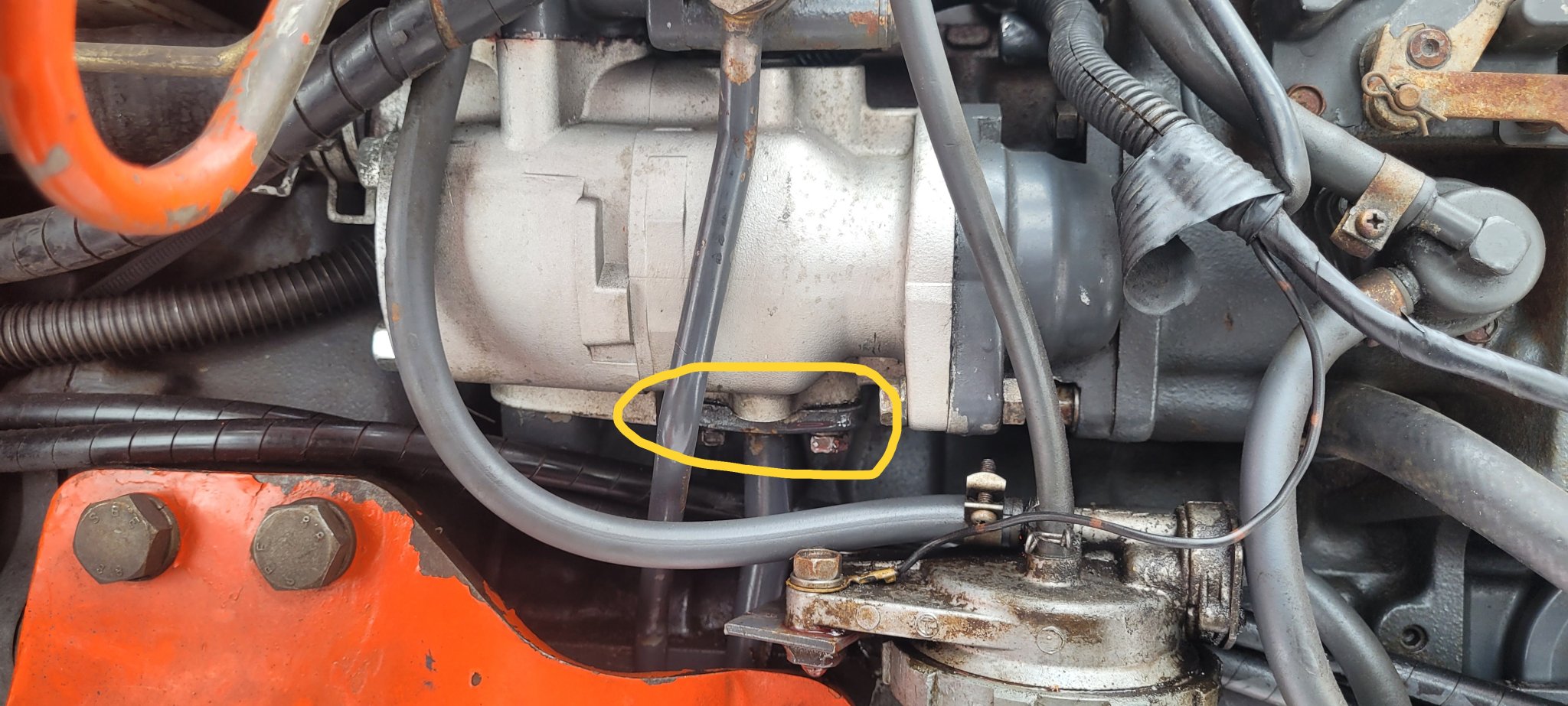

Could have a plugged vent causing it to overpressure and leak.

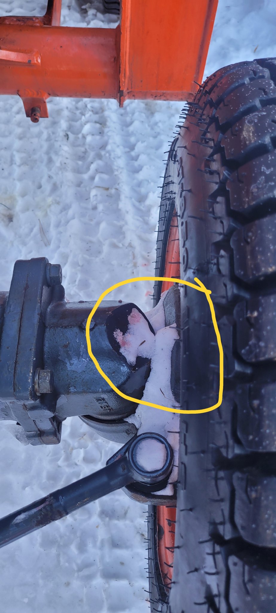

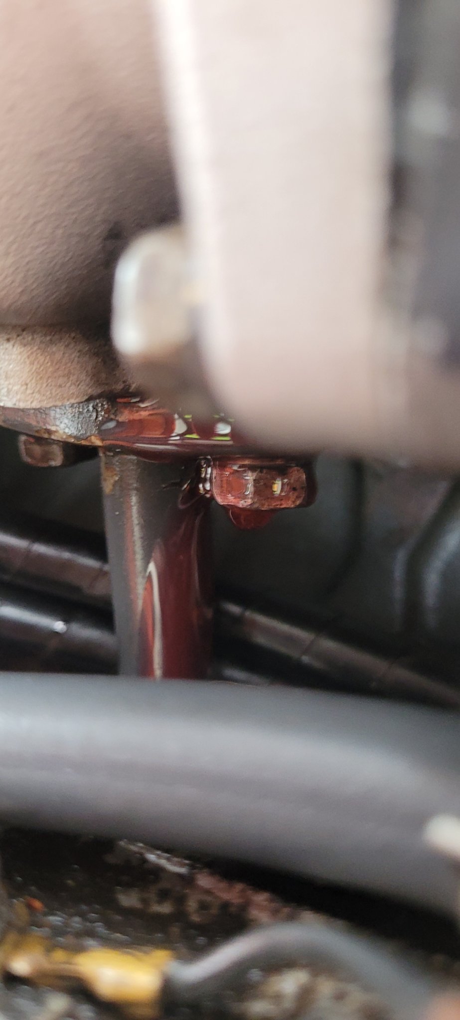

I'll try to attach some photos and maybe things will make sense. One piece that is interesting is that when I parked the tractor last tie, the sight glass was nearly empty. Right now it looks full. Is it normal for the fluid level to drop in use and then settle back to the tank when the tractor is turned off? Should it drop that much?
Regarding the fluid - I am not sure what Kubota is putting in it, but I am in Canada, and I think that up here they use a different fluid than they do in the US. Not entirely sure about that though.

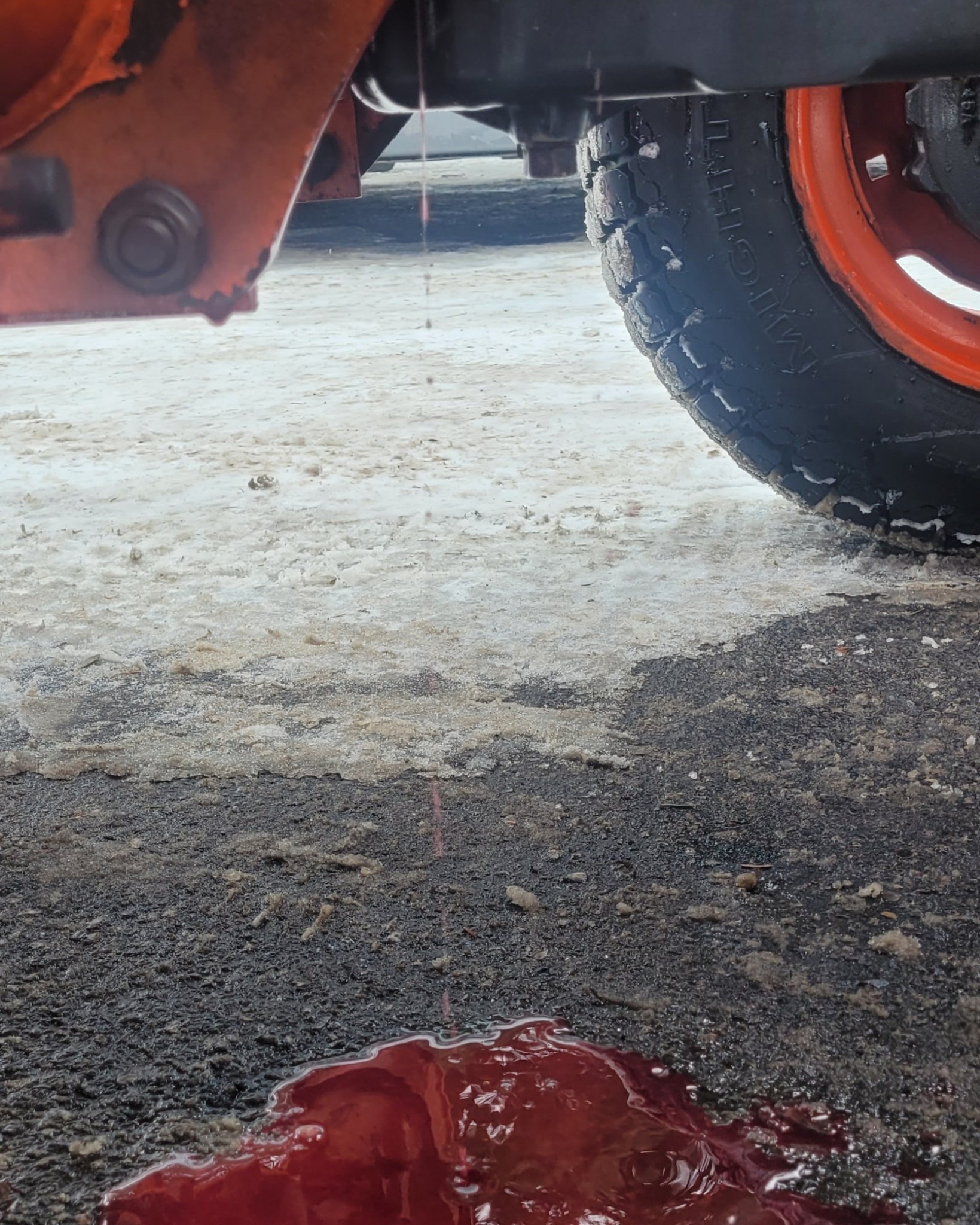

The largest puddles are forming under the pump. Leaks at the front/rear are much smaller.

Is all this after the dealer worked on it?

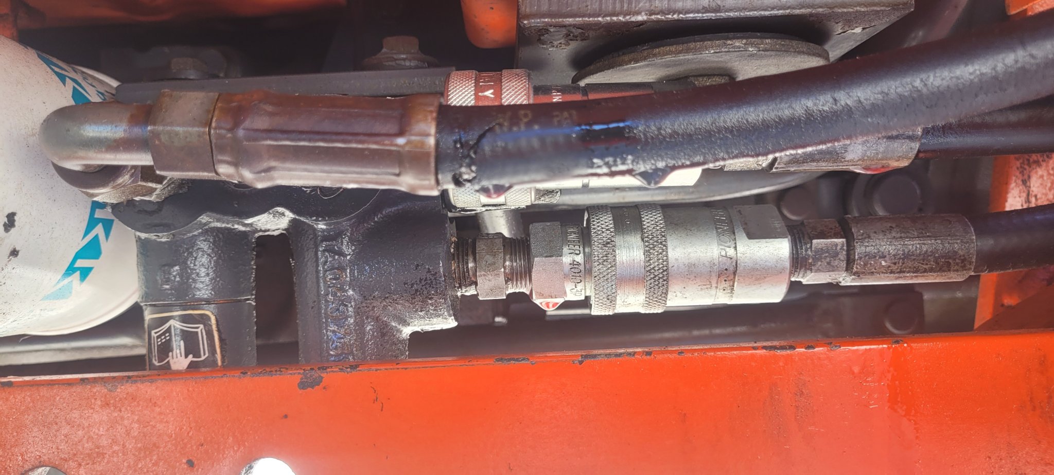

The first picture looks like a busted hose. Simple fix.
The oil on the axle is it dripping from the loader arm? Same with the picture of the oil in the snow, dripping from the loader arm?

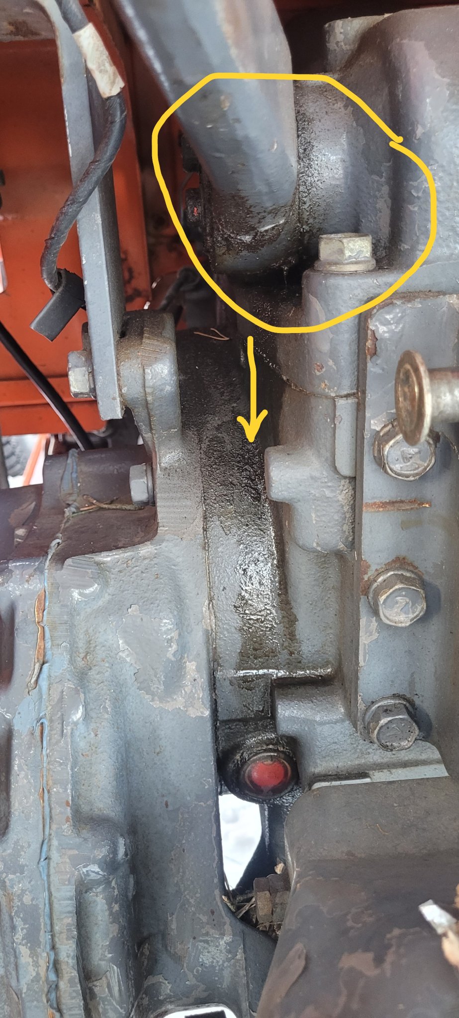

The picture around the rock shaft needs to be cleaned up to see where it’s leaking from as it doesn’t appear to be “red” hydraulic fluid.
Thanks Jason. Yes, all these were taken this morning. The dealer fixed it last week, I cleared snow over the weekend, this is what I have now. The tractor was actually dripping when it weas dropped off here, and they told me it was just a matter of wiping things clean.
I wondered the same about the loader arm dripping on the axle, but I can't see a leak there. Some of the hoses are aged and cracked and need replaced. This leak is the least concerning to me. I was planning to replace all the old hoses anyhow.
I hope you are right and I just need to replace a bunch of hoses.
What do you make of the leak at the rear? How hard is it to replace seals in the 3pth?

The leak at the 3pt IMO needs to be cleaned to verify the location of the leak as it’s not red like the others. Looks to be darker like motor oil or grease residue.

I tested your theory on the leak at the 3pth, and you're right. Black goo - probably oil. I thought the fill cap back there was for the hydraulic fluid though, how does oil reach that joint? Could it be grease that got hot and ran?
Discount hose, LINK , is cheap and effective way to get all the hoses done up.
Most all the leaks all look hose related.

The leaks on the rock shaft (three point arms) is fairly common when they get older.
You should check the vent to make sure it's clear as that will exacerbate the issue.
That will be hydraulic fluid it's just dry.
I really worry about what fluid they have in that tractor, and if it's not the right fluid that can cause some serious issues!
I would do a complete fluid and filter change just to be sure!

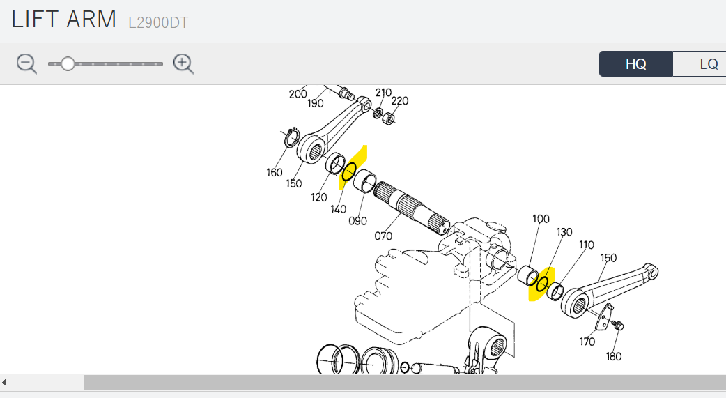

Yes #070 is hydraulic fluid fill, there might be mutiple fill points but they all reach the same point.
And any fulic that gets to the roick shaft (three point shaft is just splash from the differential.

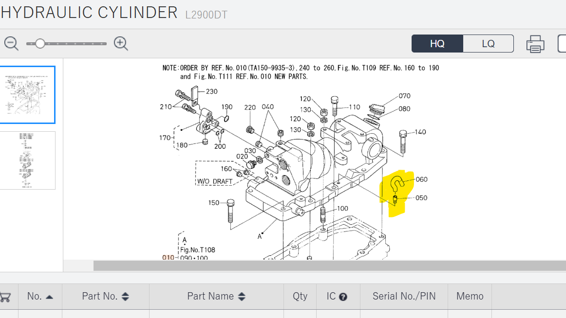

Check this vent:
There is 2 Simple O-ring seals that seal the ends of the rock shaft.
They are not super easy to get out and replace, but it can be done.
