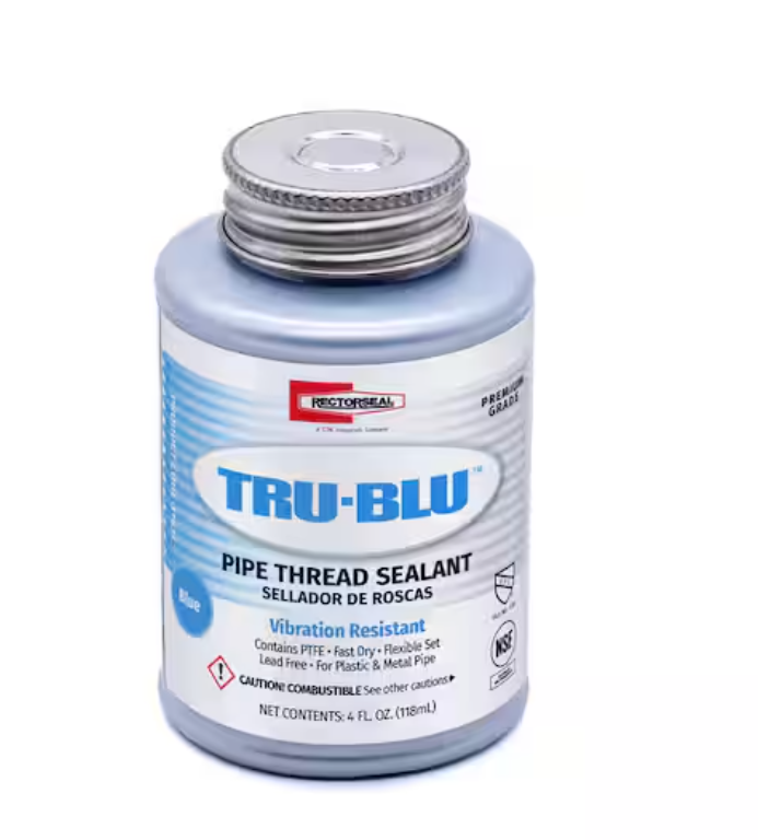

It's brass don't over tighten it.
If it's leaking on the stem of the valve, tighten the nut on the valve slightly.
You can get this it at HD

It's hard to tell, but appears to be leaking where it threads into what looks like a larger nut on the injection pump. I have a can of rectorseal #5 that I can use, but was concerned about using any kind of sealant on the system.
Ill have to see if I can get it back out and goop it up a little to stop the drip. I will say the little wheel turns quite easily, so maybe that needs a bit of snugging up first to see if it helps.
