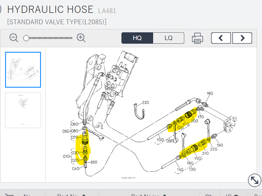

It sounds like you lost hydraulic power from the tractor to the FEL valve and so no power out of the FEL valve to the 3PH.
I suggest that there may be a quick disconnect not 100% connected since it was sudden. There should be a block on the tractor where three hoses are connected. Follow those hoses to where they connect at the FEL valve and if there is a quick disconnect take it off, clean it and then reinstall the disconnect. Clean all disconnects at the valve and reconnect them is another way to achieve the same goal.
If that doesn’t fix it look at the same block where the three hoses connect (or read your operator manual) to see if there is something to turn the hydraulic flow for using the FEL when installed. Turn it fully one way and everything should work, turn it fully the other direction and only the 3PH should work. Nothing might not work if it is turned only halfway.

Disconnect and reconnect all of these:

Thanks for all the helpful advise. I started with the quick connects under the tractor. Then appeared to be connected correctly but I unhooked them, cleaned and reconnected. I was going to move on to the pump adjustment but started the tractor to check. Everything was back in working order. Thanks again.
