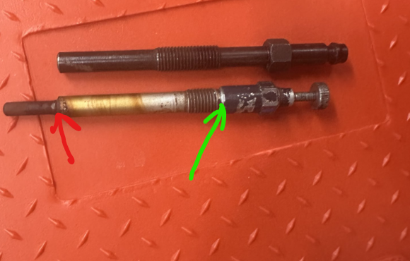

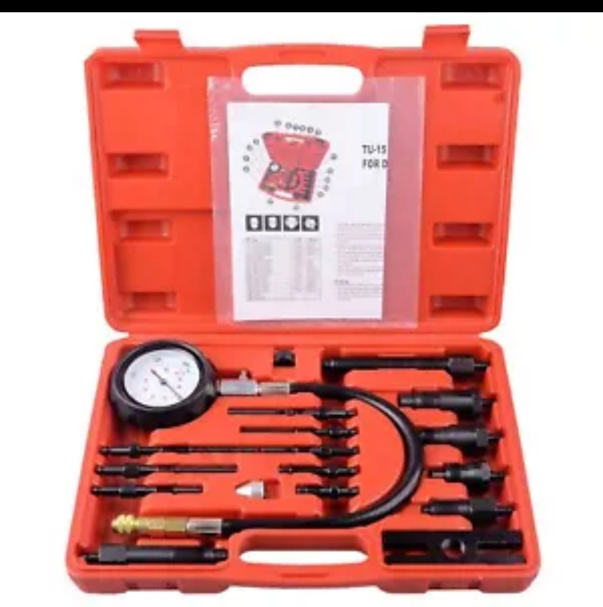

L2850 Glow plug adapter
Selkirk_D
Kubota L2850DT-GST
Dec 5, 2024
9
Northern Idaho
So my new to me L2850 starts easy, runs good, but it smokes some, whiteish smoke. It has 2500 hours , and the maintenance records show that valve seals and #1 injector were replaced in an attempt to address the issue. No oil loss, no milky oil, and no coolant loss or abnormal system pressurization. I want to run a compression test and I have the kit from Amazon. My question is , what adapter do I need for the V1702 DI engine? Is it 8mmx 1.0 or 10mmx1.25 “short”?
