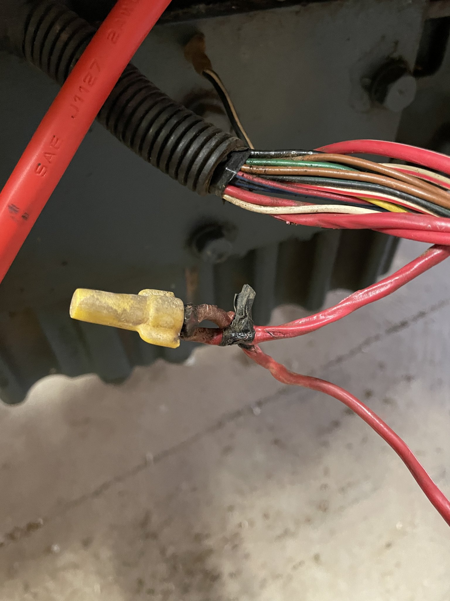

I needed a new battery and cable for my L2850 and when I attached the cable to the post the tractor started and it fried the wiring to one of the harnesses. After closer inspection, the lead that goes to the clutch safety had slipped off and the cable was making contact with the tab and arcing. The pic shows the wire nut melted. My question is what does that wire power? Is there a fuse that was possibly blown and could there be any other damage to any components?

That's the main power feed to the tractor there was supposed to be a fuse or a fusible link where the wire nut is.
You can get a replacement 40 amp maxi fuse and holder or a green fusible link at an auto parts store.
Looks like the wire going to the alternator got pretty hot.
Put a 40 amp Maxi fuse or green fusible link inline and if nothing pops you should be good.

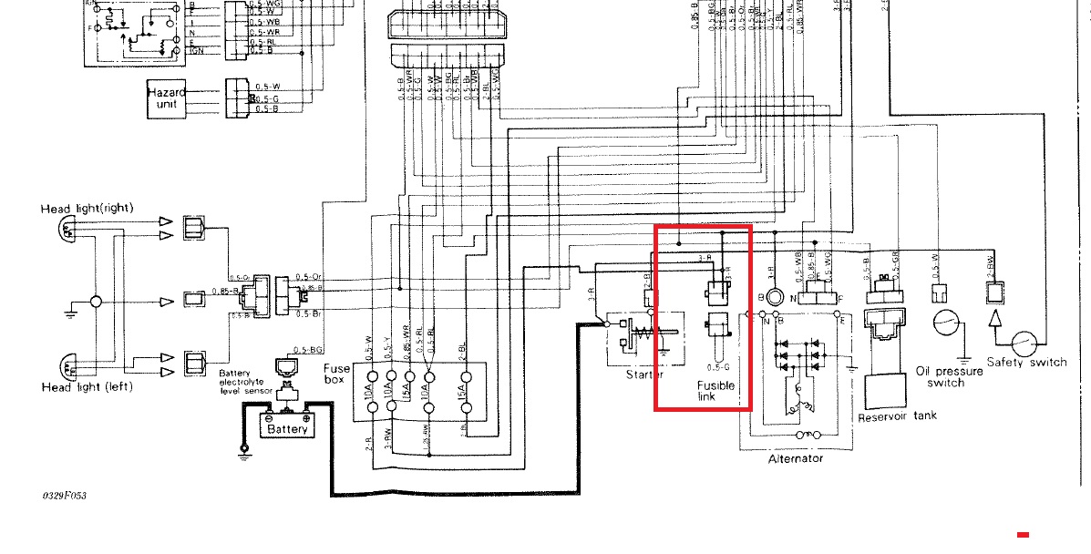

There is a electrical wire nut tying two wires together. White or almost white in color.
This is a sign of a previous do it yourself job possibly the replacement of a fusible link.
If I am correct your tractor has been operating without serious electrical protection.
The color of the fusible liok wire indicates its ampere rating.
Dave

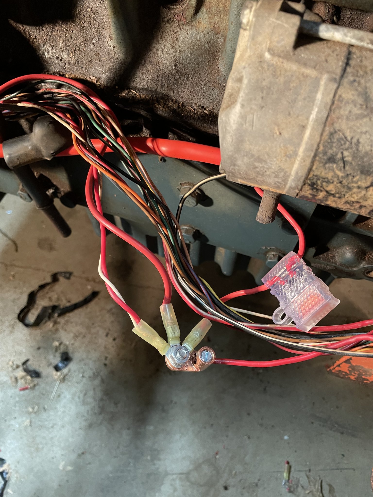

I got everything connected and when I put the cable on the battery post it crackled a little and about 5 seconds later the alternator started smoking. I put new wire to the alternator because the old one was damaged. I’m the pic, you can see the 40amp fuse and the alternator wire. Not sure what the smaller red and white wires are. They are connected the same way before I was having trouble. The single red wire after the three terminals runs to a wire harness with a red/white wire. Everything other than the smaller wires are following the wiring diagram in tue manual. I’m not sure what’s going on but it’s getting really frustrating. I can take the hot wire off the starter and with the battery cable I can jump start off the solenoid. Any ideas? I’m running out myself.

Well I studied the wiring diagram and I have everything correctly wired. The 10 amp fuse to the panel regulator was blown so I replaced it. So the next thing I did was disconnect the alternator from the battery since it was smoking when I connected the cable. When I connected the cable again there was no crackling but there was something that clicked one time as the cable was connected. The engine did start normally. Before I changed the battery, when the key was in the on position, 3 of the 5 panel light were lit. Now when I turn the key to on, only the far right(low oil pressure) is lit. I also cleaned the ground connection at the frame. I’m still stumped why the alternator smokes when I connect it. The new battery is a little larger than the old one. Could that be the issue?
The battery is no issue, larger is better. That alternator may be spent, take it to a shop to have it tested, repaired or replaced.

And also the poles seem to be reversed on this tractor. The negative goes to the starter and the positive is ground. Is that normal?
No wonder you have issues, that is wrong. Install correctly and then see what else you damaged. There hasn't been positive ground on anything in years.

When I put the new battery on it I had it turned so that negative was ground. When I touched the cable from the starter to the battery, it threw sparks and put burn marks on the battery stud.
12,715
5,521
sounds like it's the wrong style battery...some have an 'R' added to the number like 1024, 1024R.
The "R" means the posts are in opposite locations from the 'normal' battery
sadly alternator is probably pooched as well as any 'computer' unless it was designed/built right.
