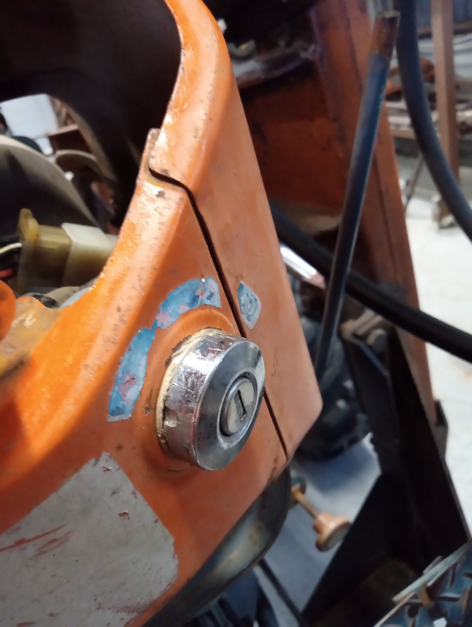

Digging into this now. Any tips on how to remove the ignition switch? It's pretty tight working back there with it in. I've pried the cap with a flat-blade screwdriver as well as tried to rotate it - neither did anything. No telling how long since it's been off.
Behind it I didn't see any ground wire attached to the sheet metel.

The key switch unscrews. The nut is the big round thing with a “groove” in it around where you put the key. It is normal thread so unscrews CCW.
I imagine it is corroded onto the key switch but I don’t think that you will be able to get any penetrating oil to the threads.
I don’t understand your picture but on my L185 to get to anything under the dash it is much easier to remove the steering wheel and then get the flat dash and cowl unbolted from the tractor and lifted over the steering column. Of course I have taken the steering wheel off recently so it is not stuck!

I've already removed the steering wheel and all bolts/screws holding the dash and cowl. The picture is from the top. There's not enough play in the wires/cables to allow me to move them that much though. Removing the screws holding in the glow plug indicator helped some to get access to the backside of the ignition switch, but I still want more.
I can tap on the screw-on cap with a hammer & punch, but holding it from the rear while I do that will be a trick.
Edit: I was able to wrangle the cowl around the steering column, so I have a bit more room to work with.

There should be some harness connections for the wire down by your feet (if sitting on the tractor) on the left side. You may have to pull the wires from the rear of the tractor since they don’t put a connector on them.
Maybe use some locking pliers on the switch body to help hold it??
If worse comes to worse, you could cut the ring off with a Dremel tool and replace it or the whole switch. Look at the pricing for the individual parts or the whole assembly including keys, they have an interesting pricing system the last time I looked. Just be careful how you buy it!
