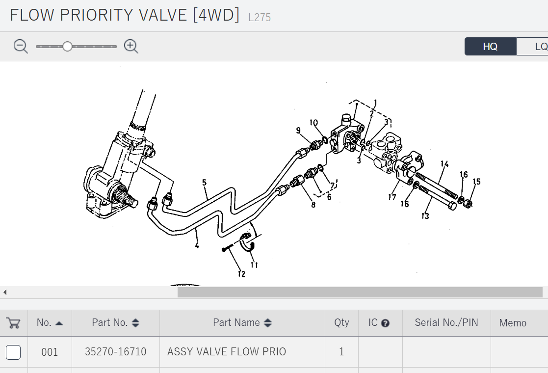

I have a mid 1980's L275DT with manual steering that is very hard to steer unless I am moving.
I have found a used OEM power steering box and want to swap it in. The PS box part number is 35270-16100 and seems to be the correct part.
Is this a direct drop in other that the hydraulics?
Can I T into my FEL hydraulics or must I get a priority valve?
Is there anything else to consider before I buy this, it's not cheap.

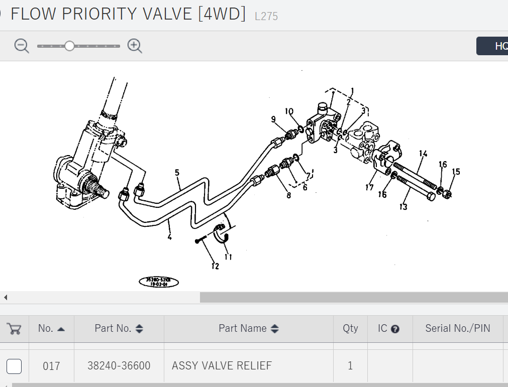

Yes you will need a priority valve and relief valve for that steering setup.
If @007kubotaguy doesn't have what you need, here are some leads.
