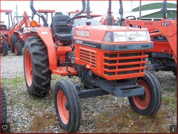

Little confused as both the L2600 and L285 are not grey's, and not even comparable versions the L285 is much older than the L2600.
What model exactly do you have?
And if you have a parts list for a L285 it shouldn't have that part Number format, Part Numbers for non grey's are in this format XXXXX-XXXXX and Part numbers for grey's are XXXXX-XXXX-X
Was it a typo, and you meant L260, then again that is not a grey tractor.

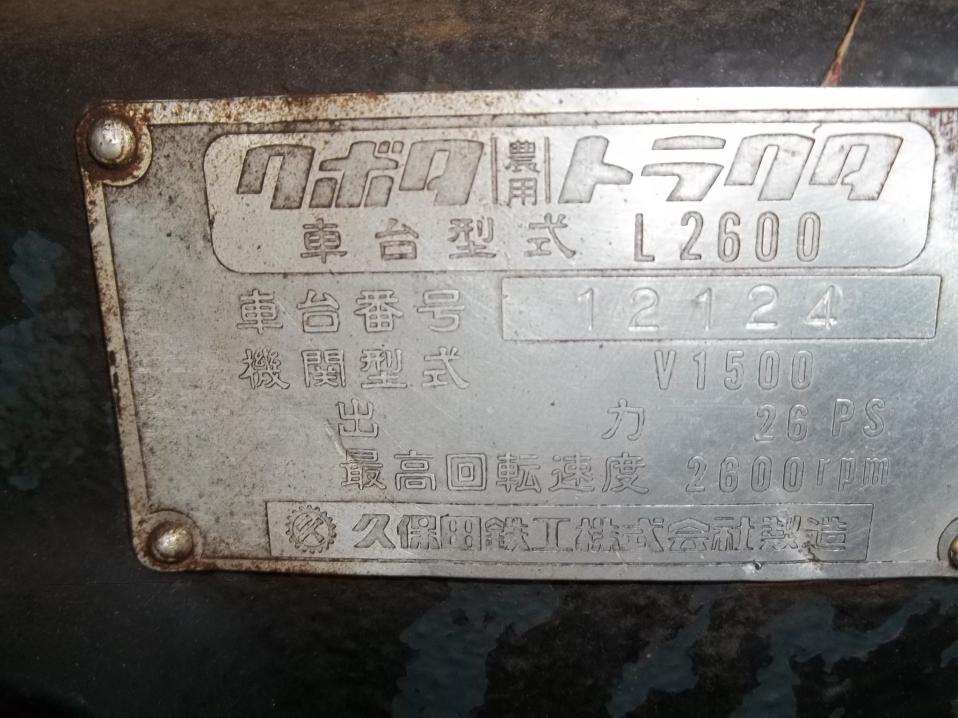

New to the forum and appreciate the comments. Purchased the tractor from a private party without knowledge of grey tractors. Got the L2600 from the plate attached to the frame which should be in the attached image. Assumed that was the model L2600, serial no is 12124, and engine is V1500. All lettering on the tag is Japanese (assume). My research lead me to believe that the best fit when looking for operator's manual was the L285. The only difference is that my tractor has 4 pto speeds instead of 2 as shown in the manual. The rest of the manual matches up with my tractor. The parts numbers referenced came out of the L285 manual. I did note when searching on line that the part numbers were close but did not have the last hyphen as noted.

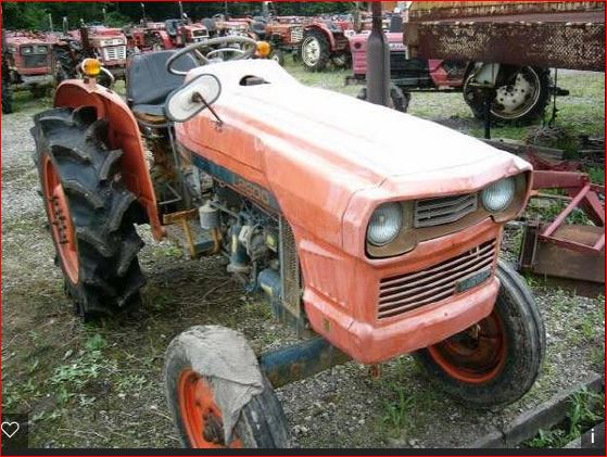

Here is a case where Kubota has me scratching my head! :confused:
I didn't know I was 1/2 wrong. :eek:
Old L2600, Yes a Grey
New L2600, No not a grey
