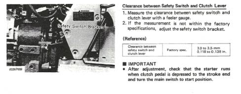

I have a L2550DT-GST that seems to have a defective clutch safety switch. When starting I have to engage the clutch 1-6 times while holding the ignition key to the start position. It appears that the switch must be bad, but I can not locate where the switch is in order to replace it. Any help would be appreciated.
