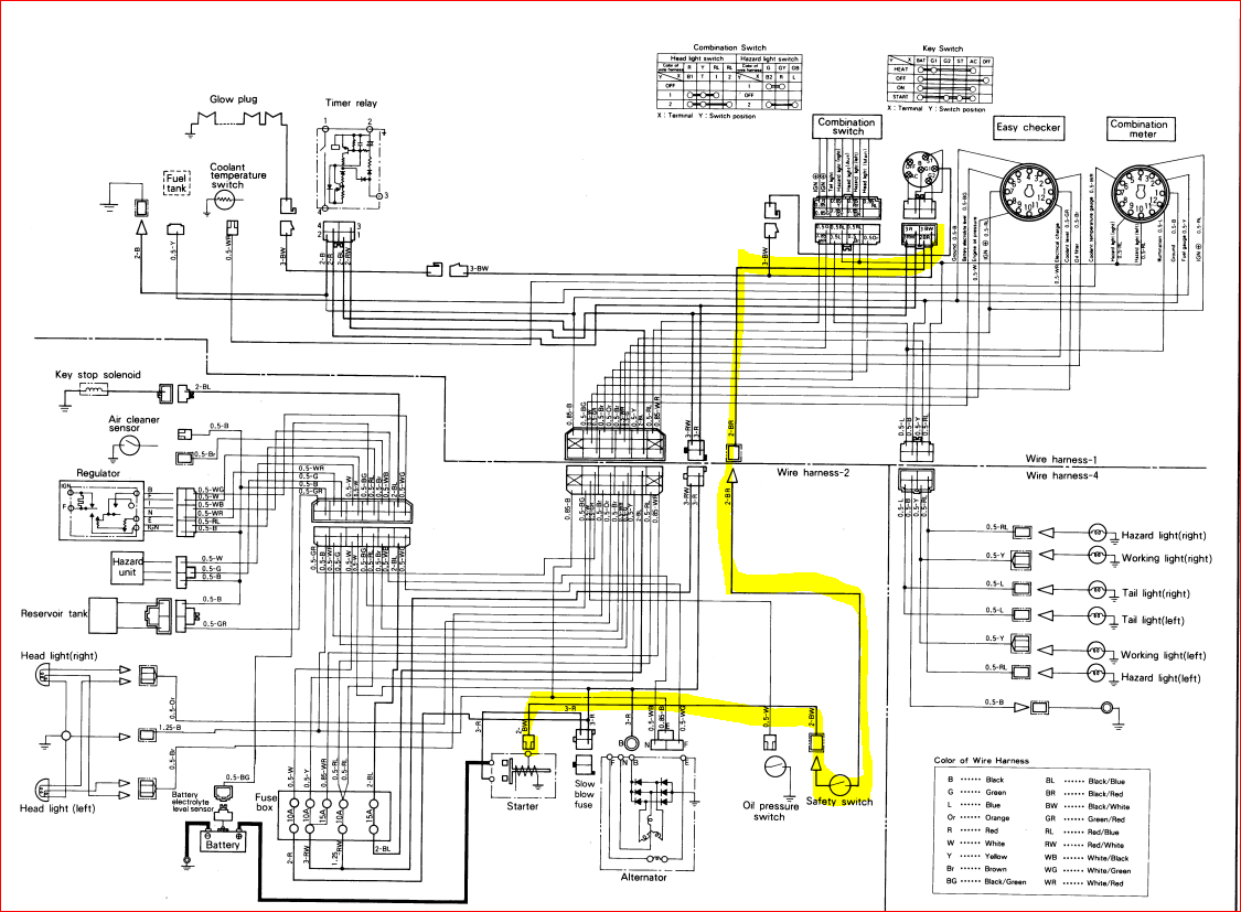

Probably a safety switch. I assume that you are pressing the clutch in as that safety switch is being pressed but stress may be making you forget to do the normal steps.
You should see if you have any voltage to the starter solenoid activation wire from the key through the safety switches to the starter (probably a black wire with a white stripe).
11,160
3,101
I see one safety switch - not sure where it is located, perhaps clutch or PTO ......
Check the slow blow fuse that it is in this diagram - it is shown right of the starter near the bottom of the diagram.

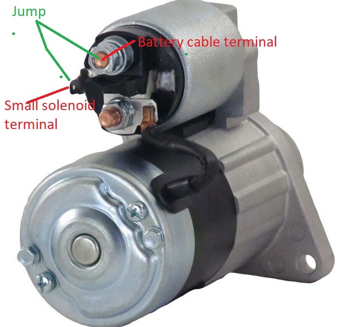

On older tractors we have seen owners with starting problems and the cause turns out to be rust between the starter and the engine block which prevents the starter having a ground path..
To rule this out, use a jumper cable from the battery negative terminal to the starter mounting bolt(s).
Jumping the starter can also be useful in isolating the problem.
Starter jumping is inherently dangerous. You can be run over by your own tractor. Have someone in the seat with the brakes applied when jumping.
Almost anything metallic can be used. Often a screw driver shank works well.
Expect some light sparking as the connection is made.
If the starter and its connections are good, the engine should crank immediately.
