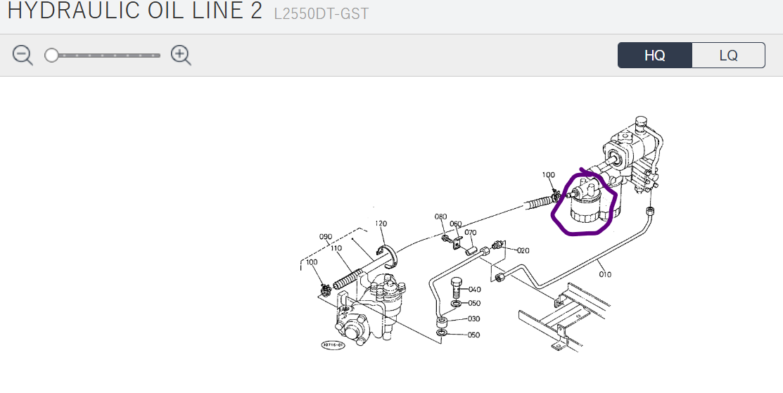

The main suction line is the top pic and the secondary suction line is the bottom pic.
The yellow (hose and clamps is the most common leak point.
