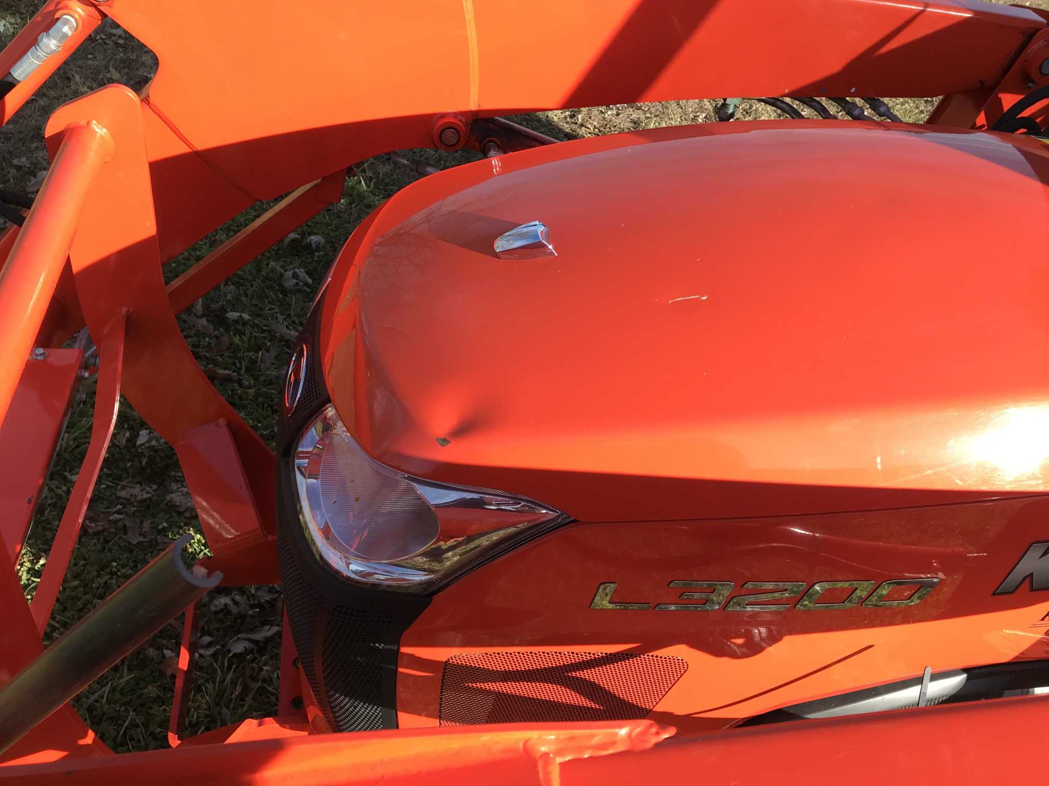

VERY soon after buying a new L3200 in2012, one moment of carelessness resulted in a small dent in the LF corner of the hood. In the 6 or 7 years that I owned the tractor I don't recall doing any other damage and that includes swinging pieces of steel around and welding for the cab fab.

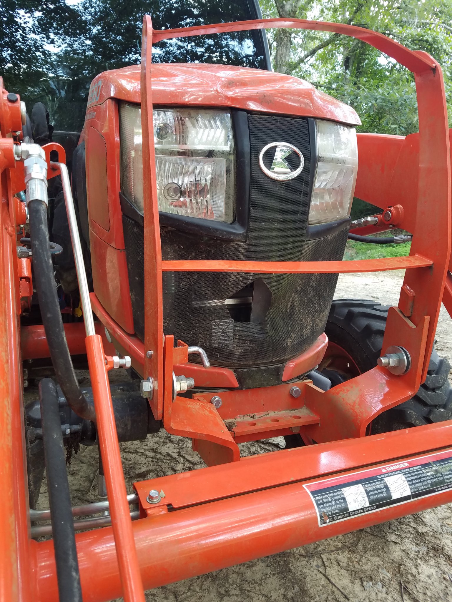

The hood? Loader, grill and hood, that's three. Should be good to go now.
