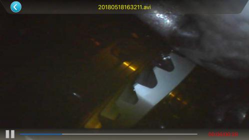

Hello,
Just completed the 50hr maintenance. My question is on my hst fluid level I’m having a hard time confirming. When I was filling it back up I was careful to watch the sight glass but I never saw it. So I kept filling. Long story short I’m almost at 7 gals of fluid. The required is 6.2gals. I put in a bore scope though the fill hole and the level is definitely above where it should be.(see attached photo) Question is being slightly higher now then the sign glass am I going to damage my tractor if I use it? I turned it on went down my drive way in different gears and articulated the backhoe and FEL and checked the level. It’s still past the sight glass. Any info?
Thank you!!!

Yeah I know I can but the way to drain the fluid has only a large plug on the bottom. Not really a precise way to remove the oil. Plus it’s only me trying to watch and drain.

Drain some from one of the small drain plugs on the final drives.
