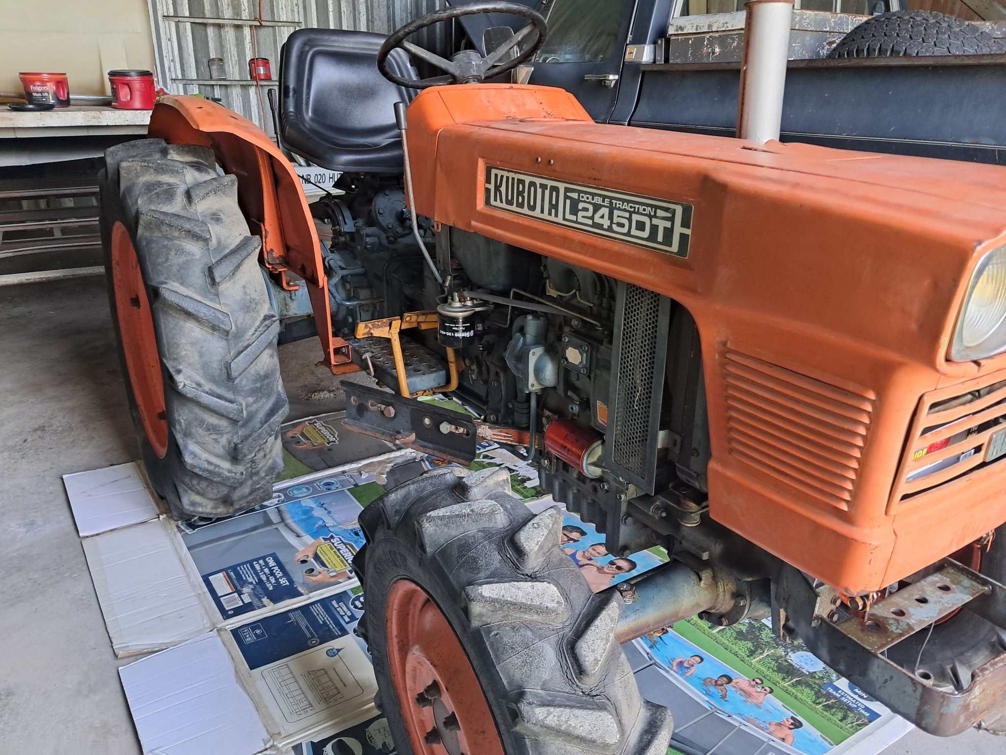

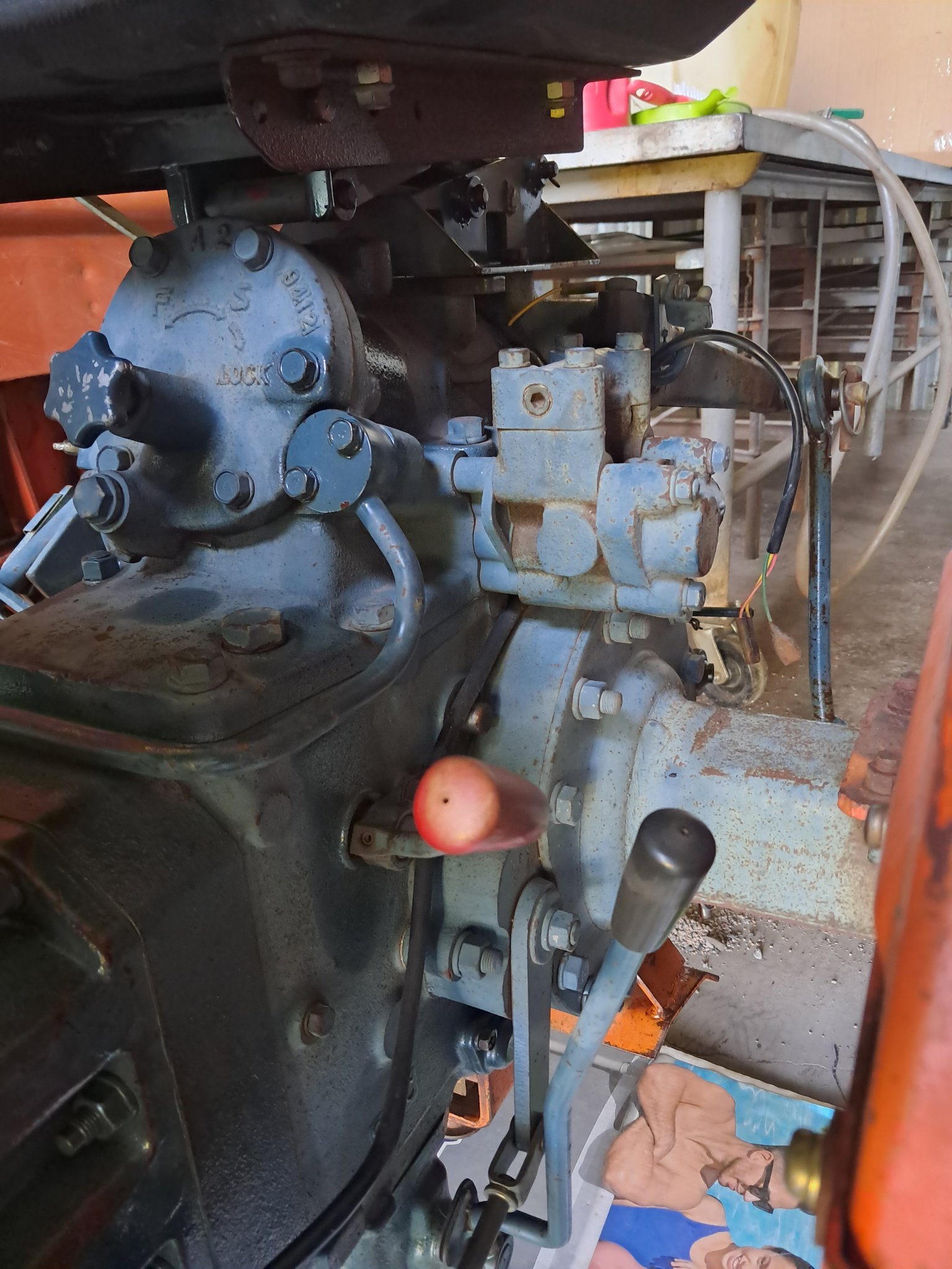

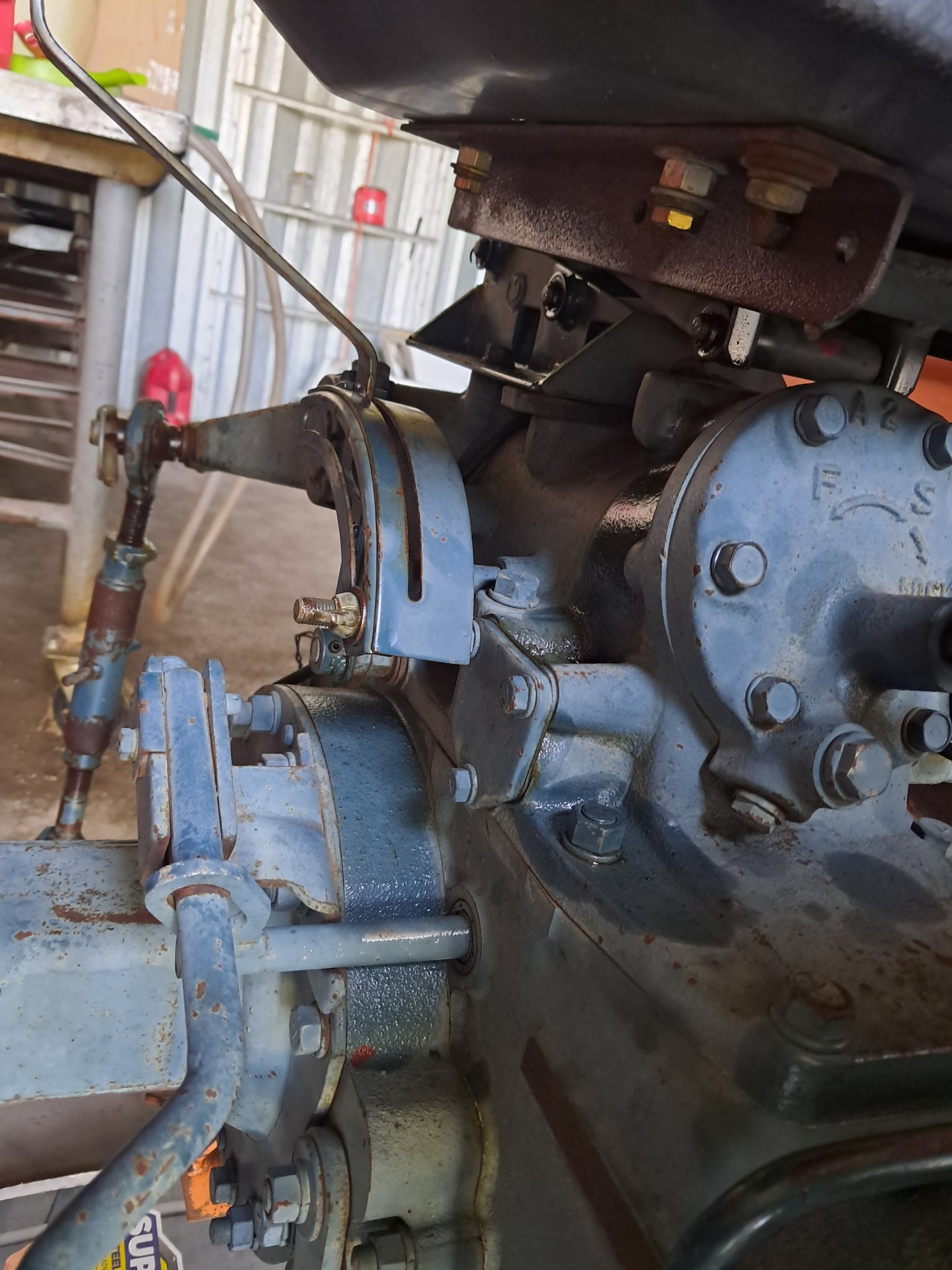

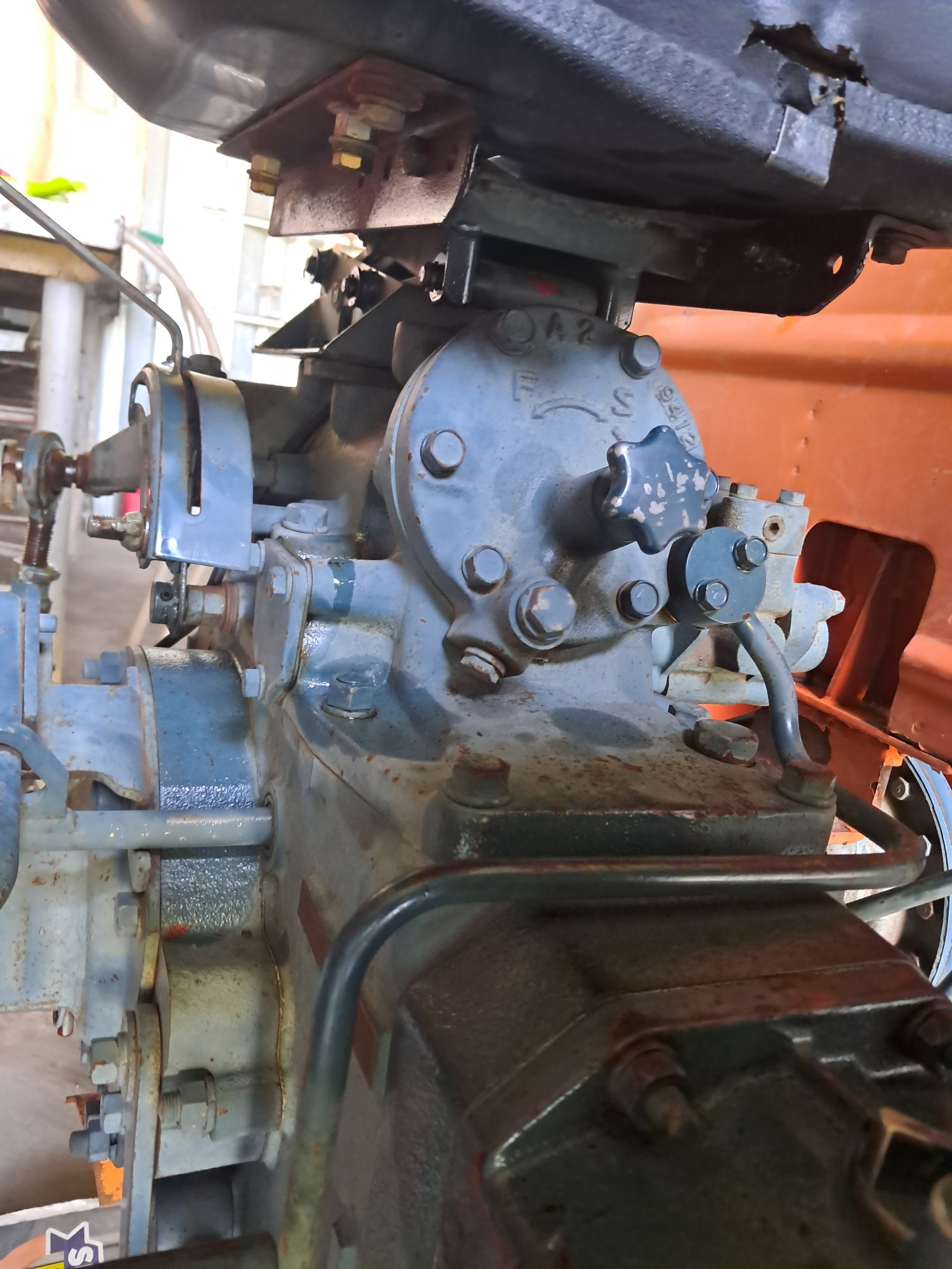

Hi. Finally got filters and fluids replaced on it after sitting for 15 years and it started right up! When parked, the 3 point worked, but the PTO did not. Now, the PTO seems to be working fine (although haven't had an implement on it yet), but the 3 point will only occasionally lift. There is not power steering or a front end loader. I've played with the adjustment knob under the seat, doesn't make a difference. Any ideas what is happening or what next step in trouble shooting process should be? Thought about removing and cleaning transmission/hydraulic filter again, but not sure if it that could be problem since PTO is now working..... Thanks in advance!

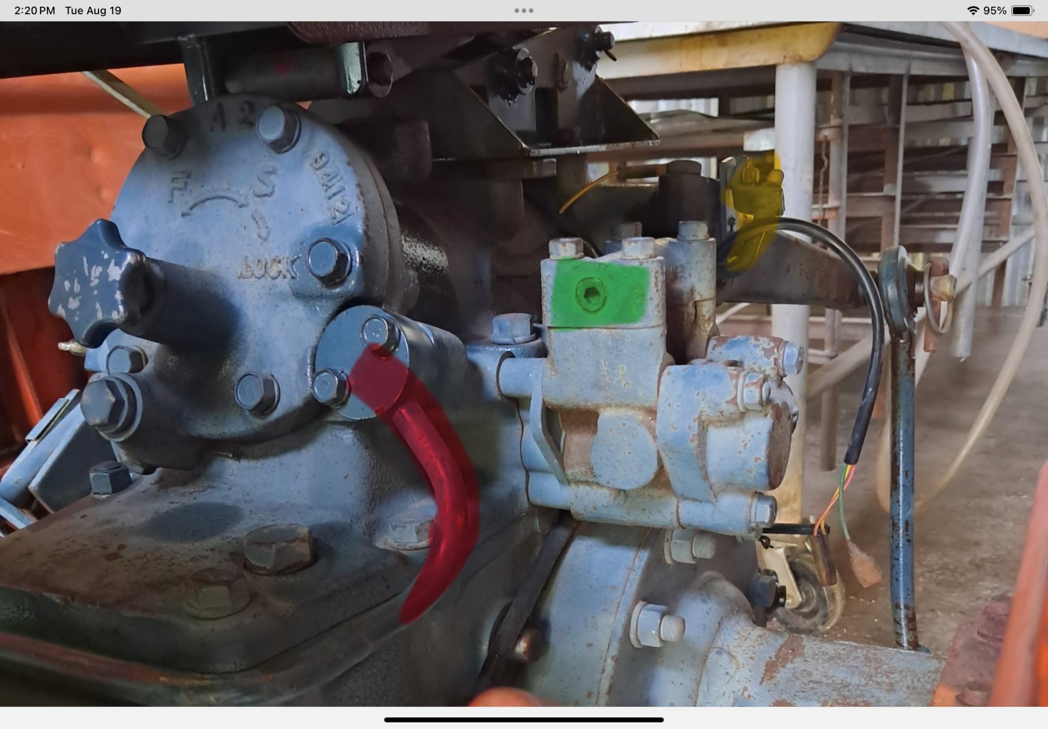

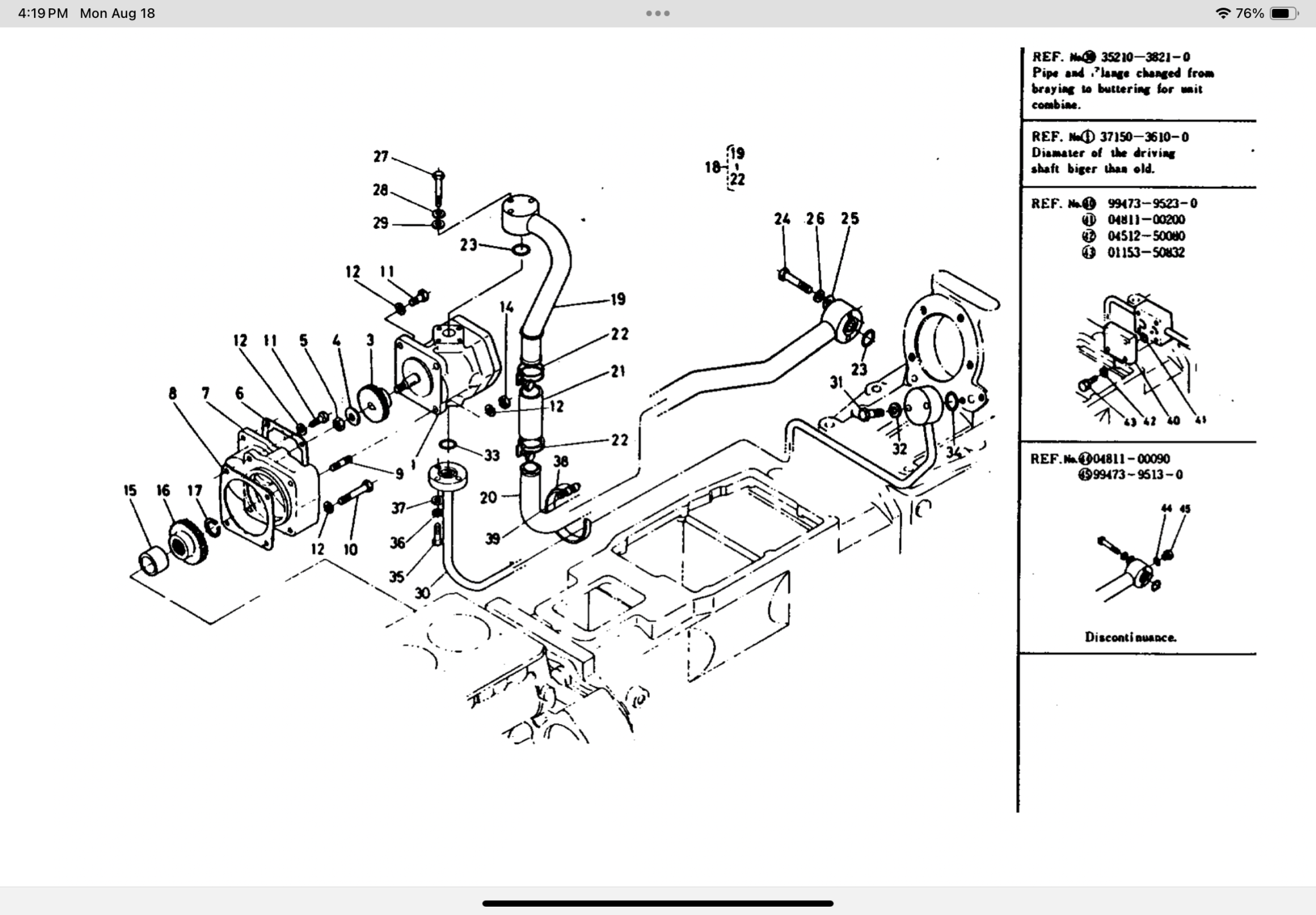

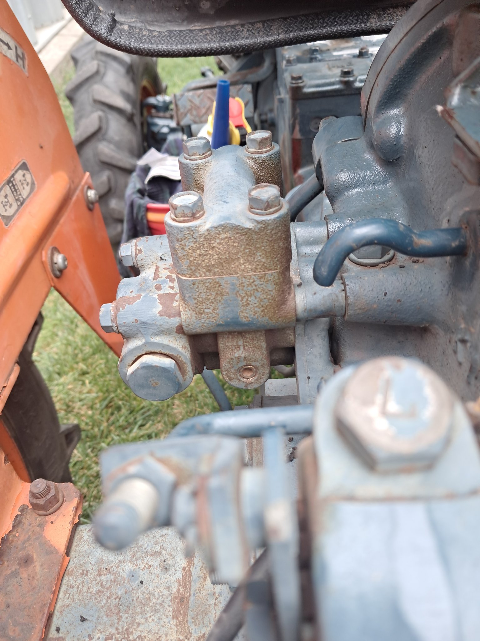

I would look at the hydraulic flow path from the sump to the pump. You should be able to disconnect something to see if fluid is getting to the pump.
If fluid is getting to the pump, then you can remove the outlet hose from the top of the pump and get a few ounces into the pump to prime it. Attach the outlet pipe and see if that fixes it. If not fixed, then remove something on the pump outlet and see if the pump is actually pumping. Actually you can start with that check first to eliminate the first two suggestions!
If you have flow out of the pump, it is probably the three point piston that needs to be repaired. Hone cylinder and replace the o-ring?

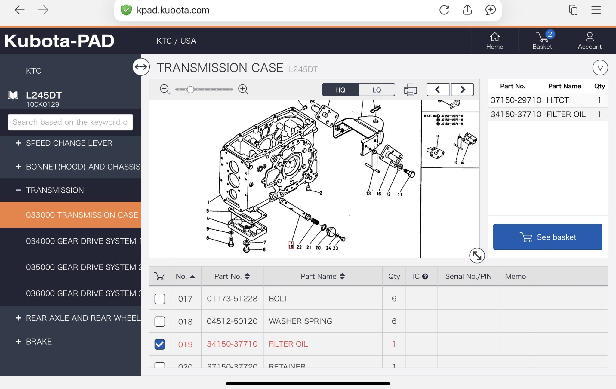

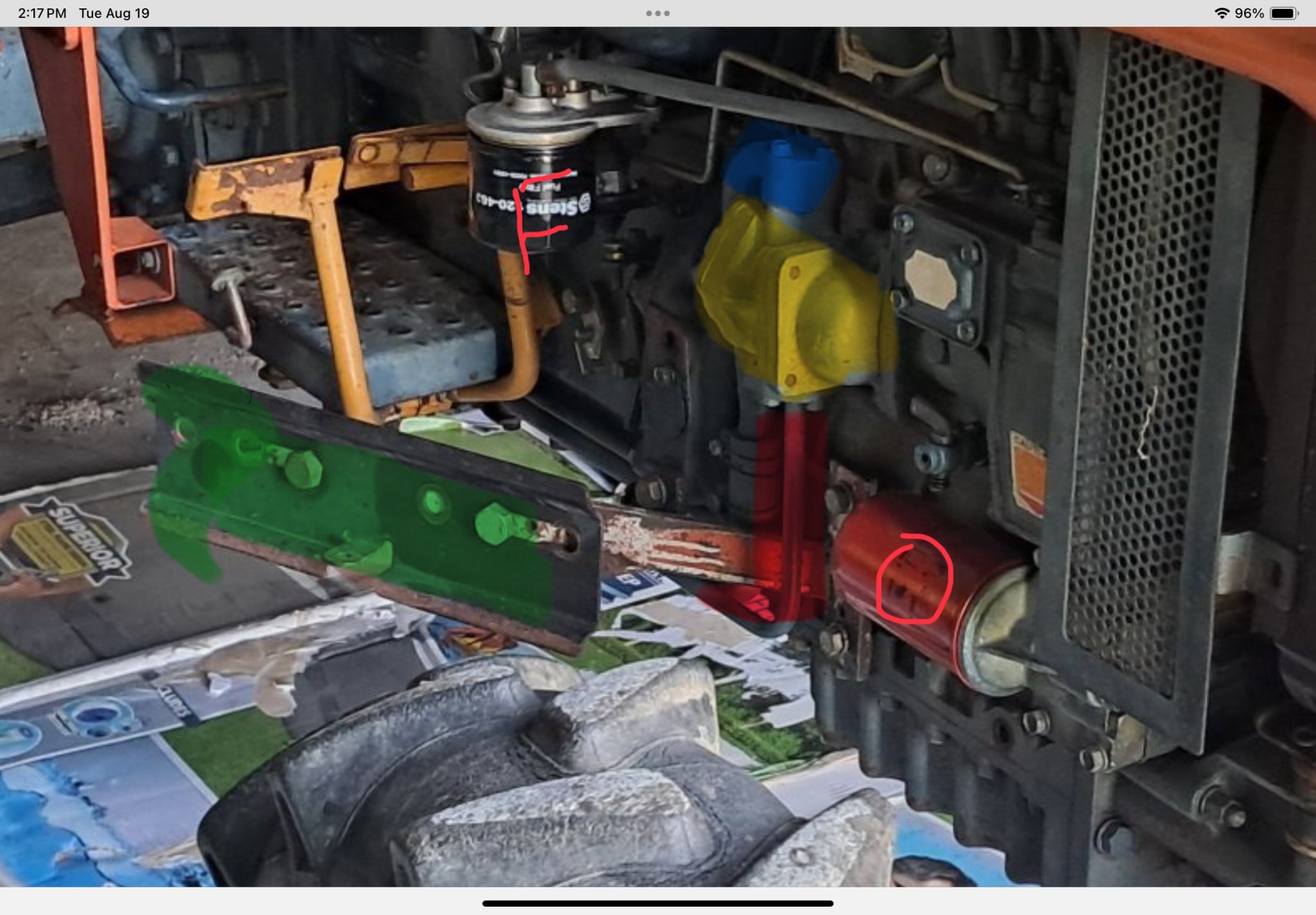

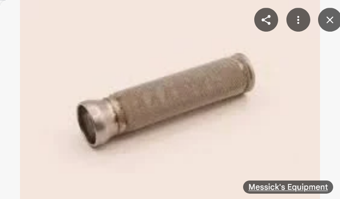

If the screen (and in this case) the filter are plugged it will not let the pump pull fluid.
What fluid did you use?
