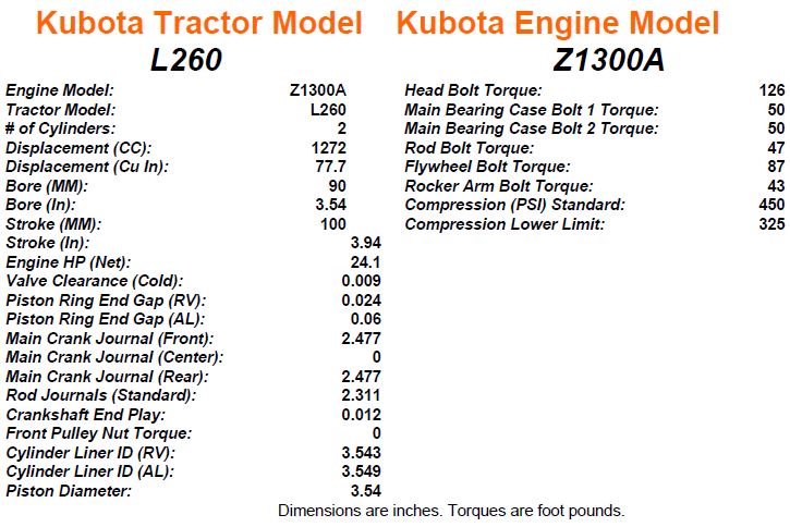

IF it is the same as the L260, here are the engine specs....
