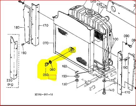

The front screen should be held in place by a thumb screw in the front.

Thanks for that. That screen was a lot easier to remove than it looked ( of course it was dusk when I was looking at it the first time) ..... Anyways I got the screen off and saw that the radiator was still quite filthy so I pressure washed it as best I could without removing the whole front end. I saw lots and lots of mud coming out of it so I'm pretty sure that did the trick so thanks for that diagram. It's dark now so I won't be able to check the other things you mentioned till tomorrow. I'll keep you posted and thanks again for your help
