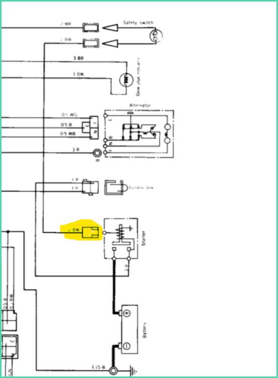

Wiring diagram for this model has one line going from one of the terminals of the key switch, to the safety switch, and another wire going from the safety switch and tying to the small negative post on the starter.
Removed the safety switch and just reconnected the two lines that attached to it with a wire nut to test if the circuit was complete. Good voltage and good continuity from the new connection to the starter. “Yes! Just fixed it” I thought.

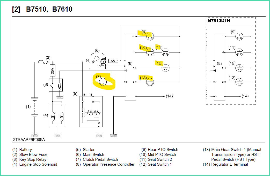

I'd want to see the wiring diagram before offering ideas - any chance you could post it?
You say "THE safety switch..." as if there's ONE safety switch. I've seen some diagrams that have multiple safety switches (butt-in-seat detector, clutch, PTO, etc.).
Troubleshooting your issue without an understanding of the start interlocks is just silly.
For example, here's by B7510 - there are SIX safety-related switches.

As far as I can see there is only one safety switch. It’s an early 90s model.

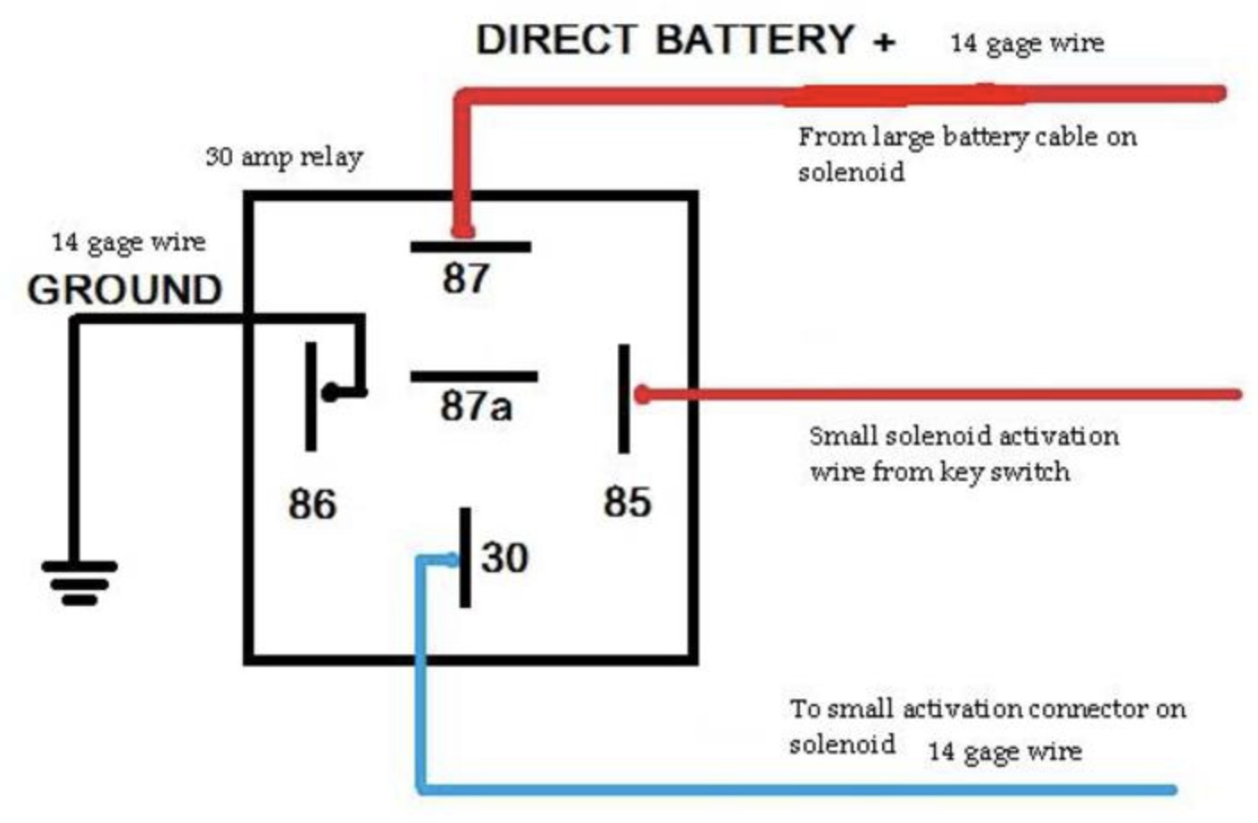

So I would suggest you start finding what the voltage is at the “fire wire” (black with white stripe?) when you have the key in the crank position. There may be so much voltage drop through the safety switches that it won’t operate the solenoid. There are relays that can be added so there is less voltage drop. Here is a wiring diagram of such a relay.
That diagram is a bit blurry, but I agree - it seems to only have one safety. Is there a more detailed wiring diagram, focusing on just the starting circuit, like I posted above for my B7510?
I'd be curious to know what voltage you have on the highlighted terminal both 'at rest' and when attempting to start it...
That’s the only wiring diagram that I’ve been able to find online. Nothing that is specific to only that circuit unfortunately. Let me test the voltage at that connector in both situations like you suggest, haven’t done that yet.

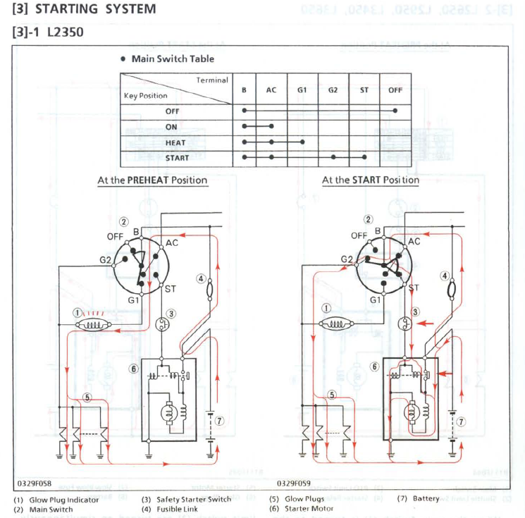

See the table at the top of the last diagram, measure the switch in each position and see if you get voltage in every position on the proper terminals.
