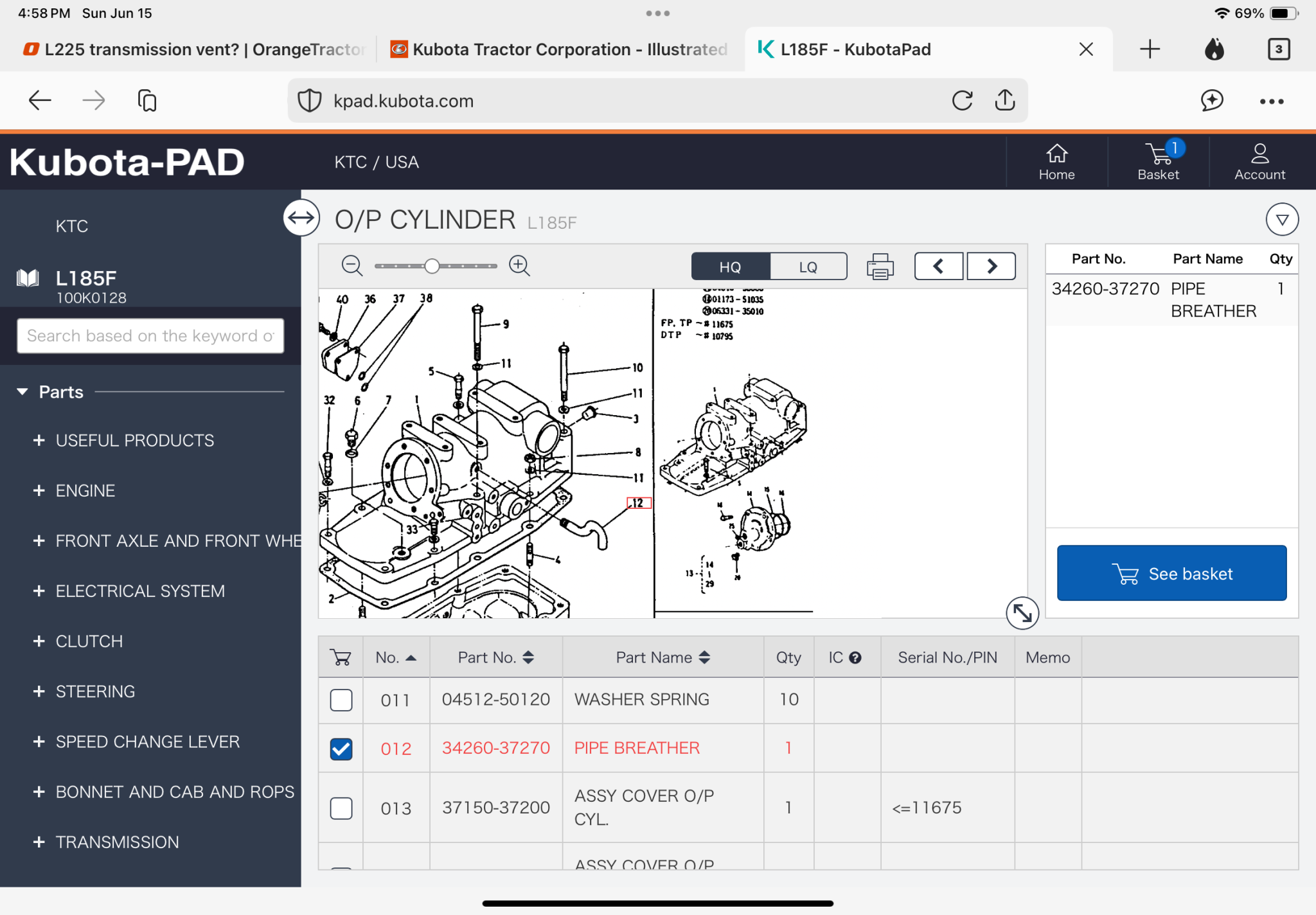

I think it is similar to my L185 but I can’t find it in the illustrated parts list for the L225.
Here is the diagram from an L185 that might help. See #12 in diagram. On left side (sitting in the seat facing forward) it is underneath the seat near top of the case and looks like a tube shaped into a question mark but on its side.

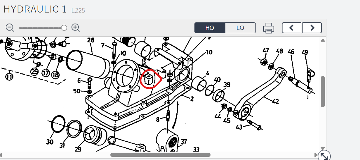

I wondered if they only had the cap as a vent:
So this is not a vent hole?
They don't show any pipe.

I looked up the part number for the L225 fill port (34150-21422) that was obsolete and looked at the replacement part to see what it fit. It was called a PLUG but used on the L175 and L225 only. Looking at the L175 it shows a similar hole in a similar position as what @North Idaho Wolfman shows for the L225. So it looks like @ruger1980 is 100% correct and my guessing that the L225 would be similar to the L185 is 100% WRONG.
The only good thing I can say is that I was keen enough to not look at the L2250 parts that returns when you search for L225 parts! I remember that happened in the past!
