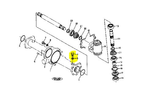

I'm actually unable to identify the level plugs from the illustrated parts list I have in hands. As soon as I will have access to the tractor I will visually try to locate them.

The front axle on that model most likely does not have 3 plugs just the fill and drain so no level plug, most diff cases didn't have level plugs because you never know if the axle is level. ;)
You will also have 2 axle cases to fill too.
Main Diff 2.6L
Each axle case .3L
