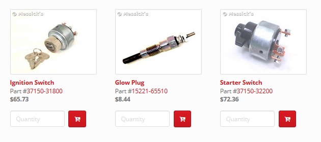

I too am having a similar problem on an older model L185. My key just doesnt want to turn as freely as it used to and have to fight to get it in the right position to start. Then often no lights. I'd love to know how to fix it.Thanks
Have you tried lubricating it. There are special lubricants for locks not just any old stuff. Most hardware stores will sell it.
If the lube job does not work, then a new switch is the next step.
Before starting to change it: remove battery negative cable.
Take lots of pictures of back of the switch so you get wires unto correct switch terminals of new switch.
Put wires unto switch before installing in dash.
For original parts, Messicks:
https://www.messicks.com/vendor/kubota
Dave
7,072
2,506
Get a new key first and see if that helps. They are cheap ($2?) and universal so the dealer can get you one or two to keep around.
