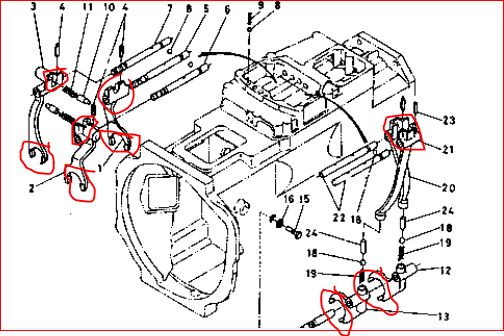

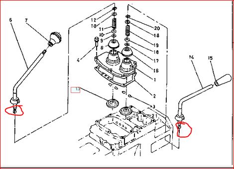

Another l185 question/problem for you: Second time in a week this happened to me, put it in gear to go forward, and nothing, motor bogs down but tractor wont move. Put it in neutral, let off the clutch, and it goes backwards. When I actually go to put it in reverse, the shifter wont go into that slot. First time, I just messed around with the shifter and it finally got going. This time, I decided to take off the transmission cover and poke around, of course I lost one of those springs in the transmission case. No big deal, i fished it out with a magnet extender, but of course you know it happened again after i had put the cover on then off, on then off...and now i cant fish it out. (finally got the tractor going, didn't do anything, just took the cover off to peek in and put it back on) So, 2 problems now, there is a spring in the transmission case, is that a problem? and secondly, what to do about this transmission getting all funky.

From what im reading here, a stop of some kind is missing, fork should not be able to move enough to allow a spring to pop out, and theres either a ball or button that spring pushes on. Its either in bore where spring came out or also laying in bottom of trans. Drain and flush with solvent.

sorry if i misinformed....the only reason a spring popped out was because i tried to play mechanic and take off the cover by the shifter....in doing so, i lost a spring as it stuck to the cover when i pulled it out. I'm looking at my parts diagram now and there are supposed to be balls with these springs. I have just ordered two new springs, one to replace and one for when i mess up again....and i ordered 3 balls as well....still not sure what went wrong

ok well turns out the guy i bought the tractor from thought of making some repairs as the box of parts he gave me contained 3 new forks and some other goodies. I had those all replaced and used the tractor quite a bit today and didn't have one problem with it.....thanks for the help
